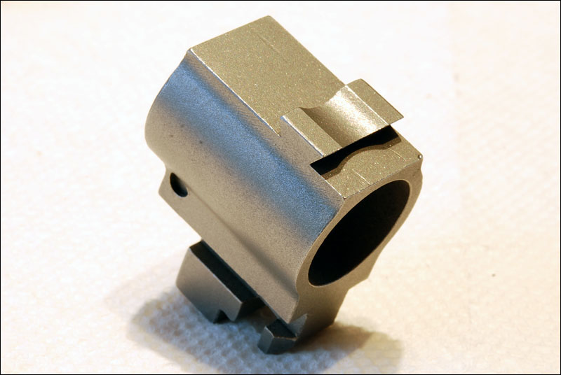

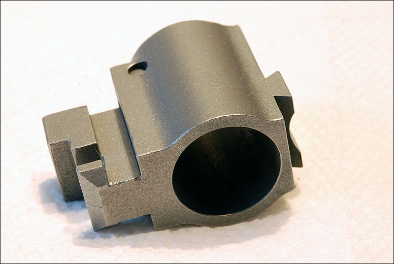

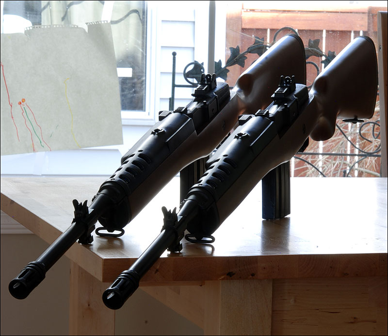

I've loved the look of the mini-14gb ever since I saw one for the first time...I owned a couple for a bit however they were nothing to scream about in the accuracy department so I wound up selling them. I still had that closet interest though and would secretly think about them everytime I'd take one of their bigger cousin M14 type rifles out for a spin. When the new 580 series came out and folks started writing about how they were somewhat improved in the accuracy department I bought a couple to play with. The couple I wound up with proved to be quite a bit more accurate than my old GBs however cosmetically the front sight of the civilian version always screamed "fugly" to me. I looked and looked around for a commercialy available GB style sight post/bayo lug but to no avail, so as a project I had a couple made up. I was super excited to pick the prototypes up from the machine shop this afternoon:
Rather than the conventional built-in sight of factory lug on the original gb part, I thought I'd try a dovetail such that an M14 style front sight could be used. The hole for the 1/8 roll pin is only just started such that it locates properly for the edge of the barrel. It has a large flat on the top to use for indexing during installation (square stock clamped to it for use as a level).
My mini-14s came back from the gunsmith last week threaded 1/2x28 for an ar15 style flash hider, and crush washers and m1a match sights showed up from brownells yesterday; I'll get to bluing the bayo lugs this evening and then do some bubba work on my ranch rifles this weekend! The plan is to mark where the lug shoud go using an array of bayonets as a measuring jig, knurl the barrel under where the lug will go, loctite the cr*p out of it, and then pound her on. Once the loctite has set up I'll drill the hole for the pin.
I'm super excited and will post pics to share my excitement of the bubba gb as I get them done! Range report to follow shortly. Sadly I don't know if the wife would approve of the feral-hog bayo hunt though....:)

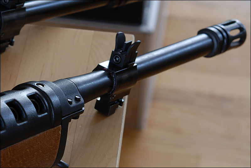

got up early and did some bubba work while the rest of the family was sleeping. Need to clean off the loctite a bit but here's a preview:
Range report to follow as soon as I can get out for some trigger time!

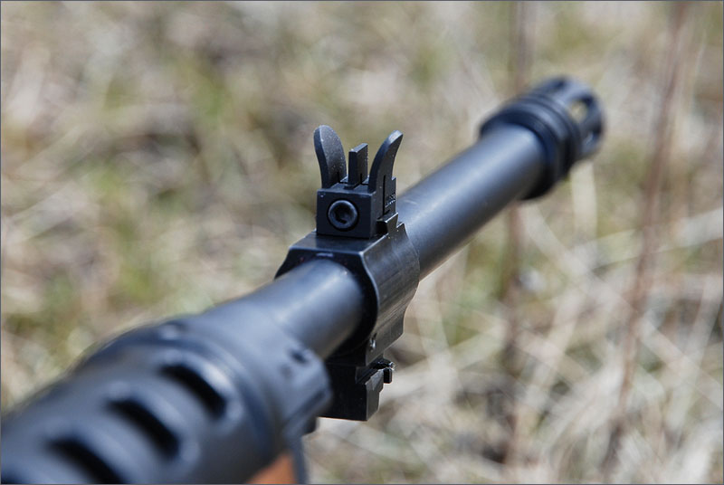

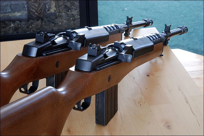

Well the wife gave me an afternoon pass and I got out to the range this afternoon...woohoo! I took two of my gb bayo/m14 dovetail converted minis with me for the purpose of zeroing and practicing some sitting and squatting practice. I also brought along the camera so I could document the sight settings when zeroed for those interested in the height geometry of the m14 type sights on the dovetail.
I zeroed both guns 2 inches high at 100 yards.

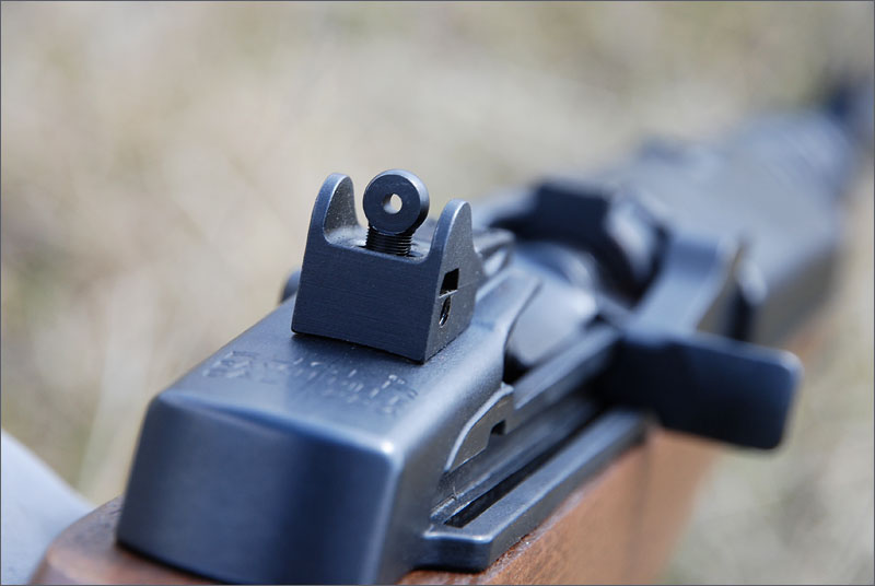

The first gun was a stainless 580 series. The M14 style sight I used on this one is a tritium bar night sight made by Smith Enterprise. From the top of the sight to the leveling flat on the dovetail sight measures 0.570.

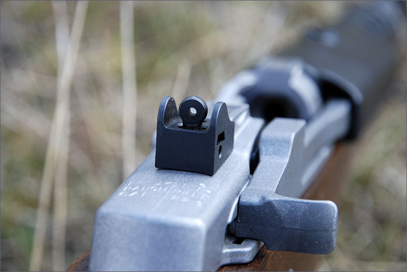

Here is a photograph of the elevation required on the rear sight to achieve zero:
And the front sight:
On the rear sight there is some room to move down and lots of upwards elevation ...all in all I was very pleased!
The second gun was a blued 580 series. The M14 style sight I used on this one is a 0.062 National Match sight made by Smith Enterprise. From the top of the sight to the leveling flat on the dovetail sight measures 0.585, 0.015 higher than the fatso night sight.
And here is the front sight:
While I was expecting to require a bit more elevation on this gun given the slightly higher front post I was using it surprised me how much higher the rear sight needed to go to get zero...certainly much higher than the 0.015 difference in height between the two front sights. I'm not too stressed about it though because out of all the M1A type front sights I have the Smith Enterprise one is certainly the highest. I have a little bin at home filled with M1A and M14 front sights and lots of them are noticably shorter than the Smith Enterprise NM sight. If I decide to stick this particular front sight (instead of going with a shorter NM sight I bought from brownells a couple years ago or another one from my bin) I'll likely mill 15 to 25 thou off the post so I can lower the rear sight a bit. There was still alot of elevation travel remaining in the rear sight, however I think it would be a bit better if it was 2 or 3 threads lower in the rear sight block. For those contemplating their own conversion I know that Springfield Armory stocks three different heights of front sights. The SE sight I used would certainly be the highest you'd likely encounter.
