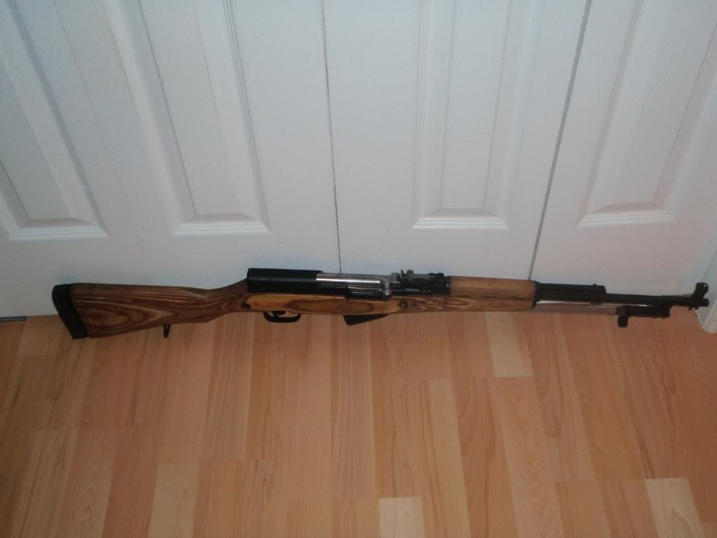

I own both - a mid 90's Norinco SKS (back when they cost $99 new) which I have put in a "draganov (sp?)" style stock. A few summers back, my daughter and I ran 22 different reloads and factory loads through it with a 4 power bushnell scope. All in all - averaged 3 - 4" 5 shot groups at 100 yards. I wrote it up and posted the results here, but they are probably long gone now ....
