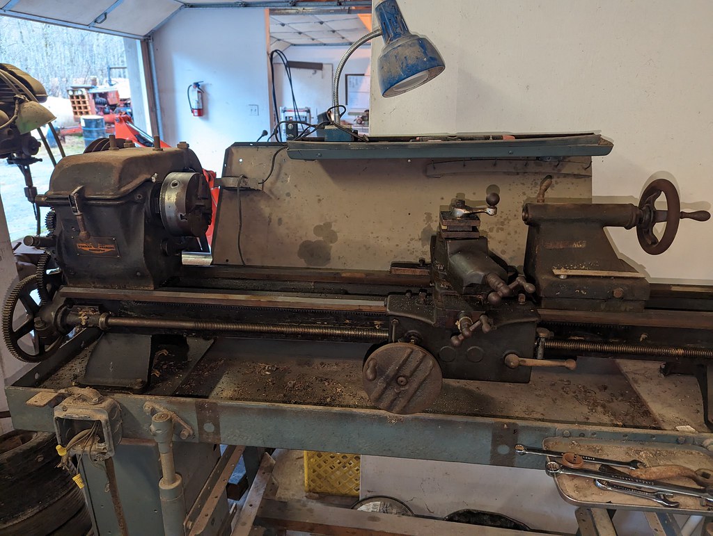

But like... Is your shop submerged in salt water part time? I don't know that I've ever seen rustier, grungier equipment still being used, lol.

Old equipment, it’s affordable. I own a good deal of it myself.
That's true the lathe I have I rescued from the corner of an old shop. The guy said it hasn't ran in 30 years. It's a 1932 Clausing lathe. It came with that 4 jaw chuck and some face plates and a bunch of other stuff in boxes. All rusted very much but it was free
But yes my shop is about 100' from the ocean and also in a rain forest
Here is the lathe after I got it cleaned up.

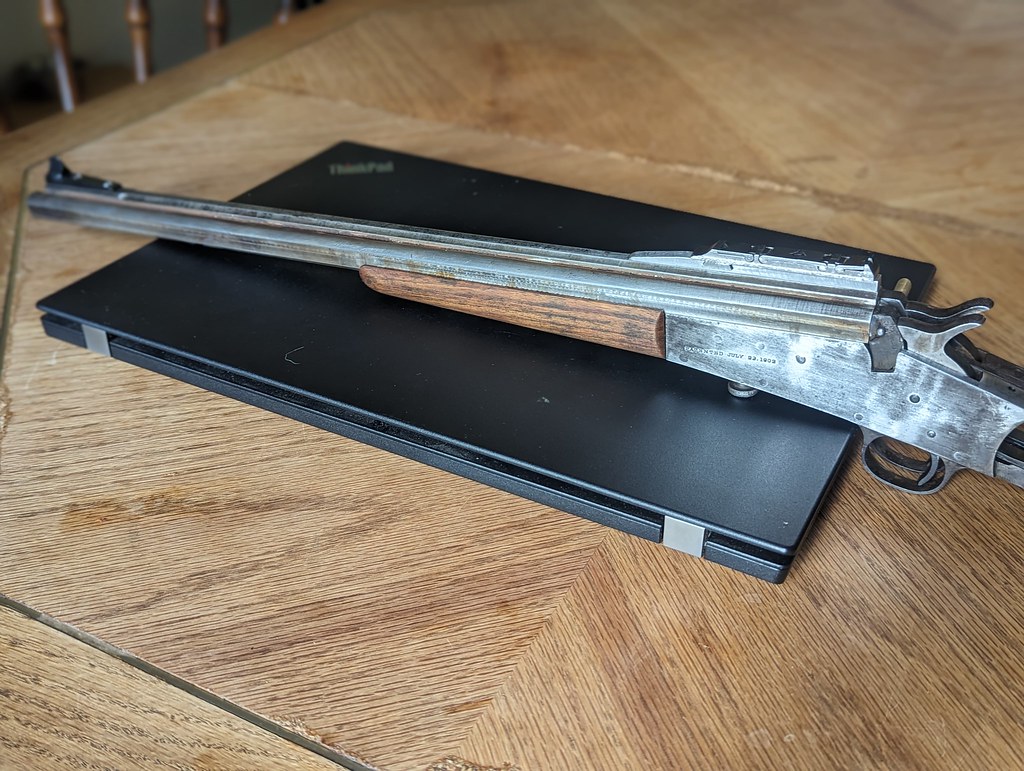

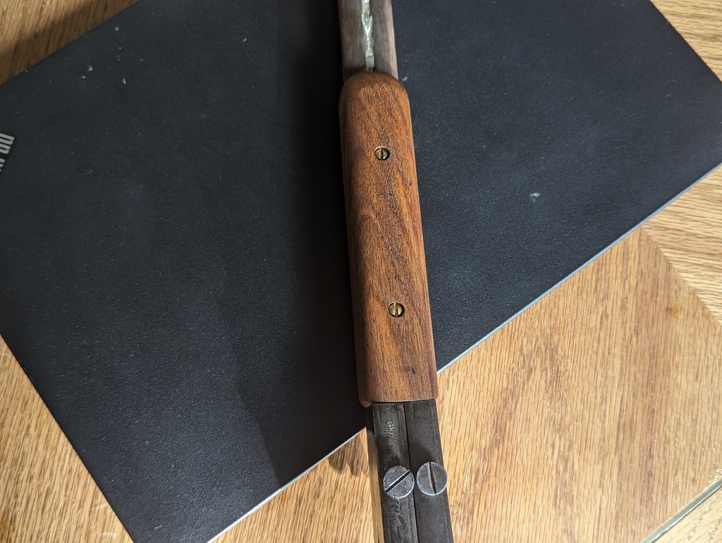

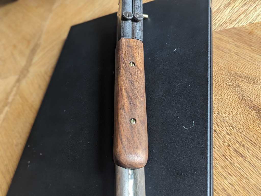

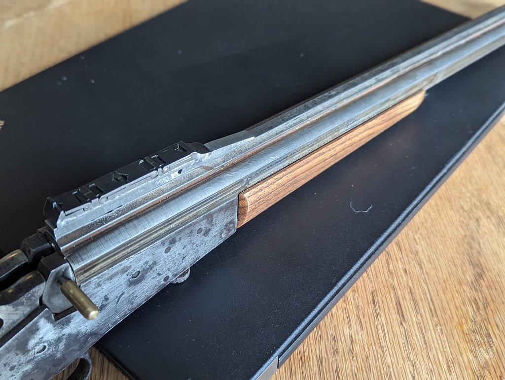

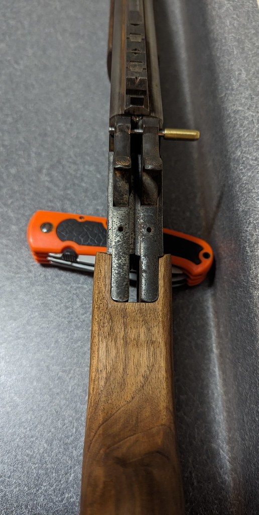

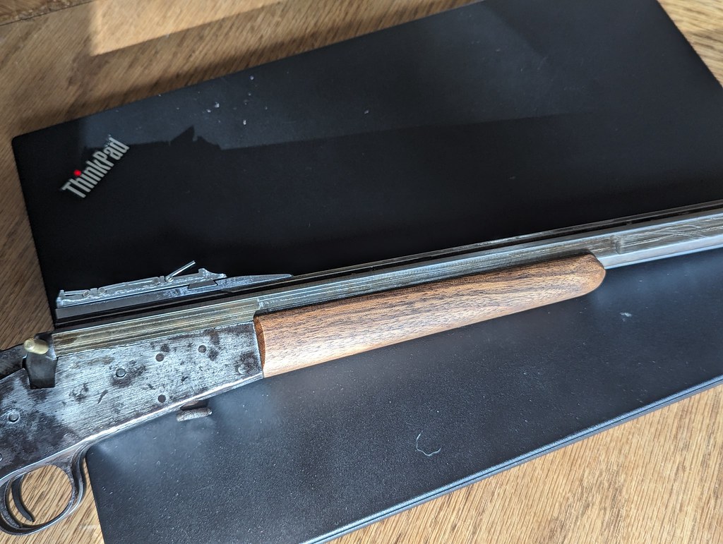

i ended up finding the time to make a fore stock for this rifle today. Its not by best work but looks and will function fine, I installed it using the factory Remington no6 method of a screw and since i have 2 receivers i used two screws (really i used 2 screws because its 6" long opposed to the 3" one that the no6's came with)
I hope to get the butt stock drilled though and started shaping tomorrow.

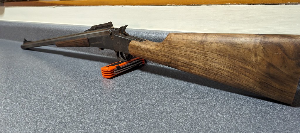

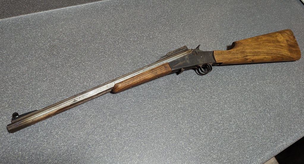

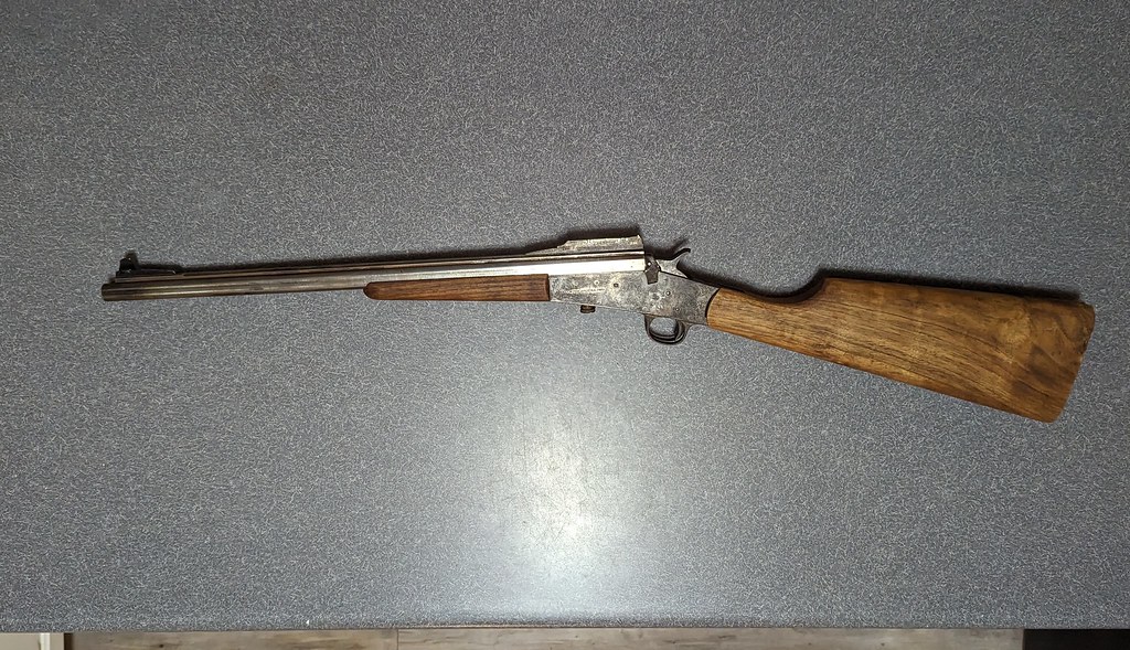

i got some more work done of the rifle, not done yet but getting there.
I roughed out the butt stock. it needs lot of fitting and sanding done still but i put a singe coat of BLO on it to be able to see the grain, the fore stock had 4 coats and is not a lot darker even though its from the same blank.
The inletting for the butt stock is on center..I'm not sure why the pic shows it way off. It must be the shadows or angle. (I used my mill to do it so it's within a few thou)
lucky for me the sights line right up with my eye when i shoulder it. so it feels like its going to be conformable to shoot
left to do is-
Finish the butt stock shape, fit it better and put more coats of BLO
Install the butt plate
Install a tang between the receivers and tap it for the butt screw
Sand blast everything to prep for rust bluing
Rust blue everything
a few specs on the rifle
weights 6 pounds 8 oz (6.5 lb)
OAL is 32.75
LOP is 13"
