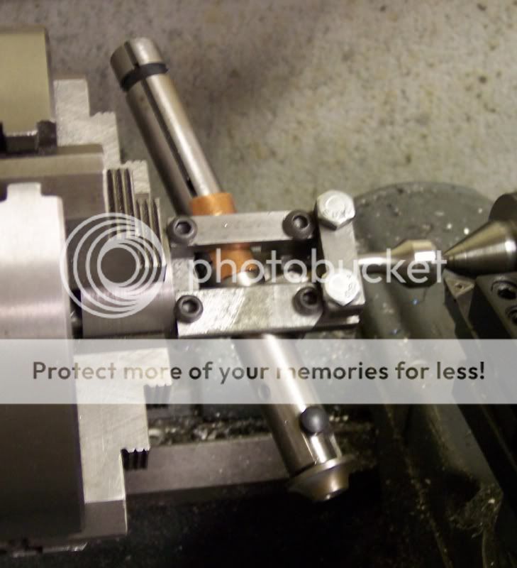

I think I may just have to head to an uncle's house to use his lathe and see if I can conjure up some lathe skills from back in high school to make a knob of my own. Maybe I'll buy a little extra material just in case. Will likely use the dremmel method to thread the handle, since the time, materials, and tools don't present themselves to make a jig for the lathe. I would, however, ultimately like the handle turned on the lathe, simply because I like things to be done the best way possible. As mentioned before if anyone knows someone with the tools and skills, feel free to pass along their info.

So not many people have a jig made up specifically for this bolt hey? damn.
