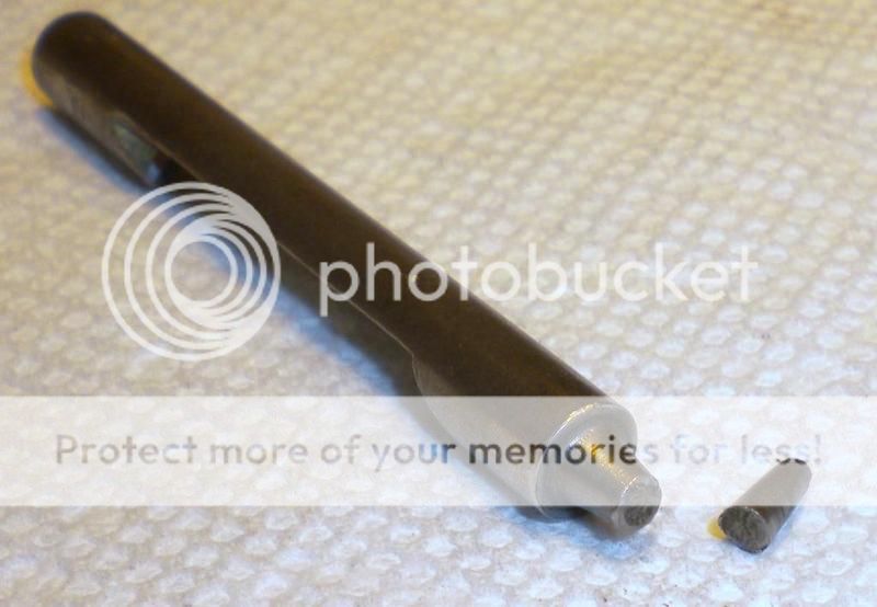

Not my words but you can see how it takes place
I am sure most on this forum are aware that a broken firing pin can still function. While the M12 has the firing pin lock, it isn't perfect.
The pin below came out of a M12 I am renovating. Test firing before tear down revealed no problems. As you can see, the pin is broken and is now essentially a "two piece firing pin". You can also see the peening where the two pieces impacted each other many, many shells.
It also easy to see how the tip could wedge in the breech face, leading to a slam fire.
___The Model 12 s are notorious for breaking the firing pin. Being tapered it is still trapped in the bolt but does not retract when the action is worked. Sometimes it continues to protrude and hangs up the shell being lifted to load. Hence it is possible that the uncontrolled broken part of the pin could also cause a slamfire
