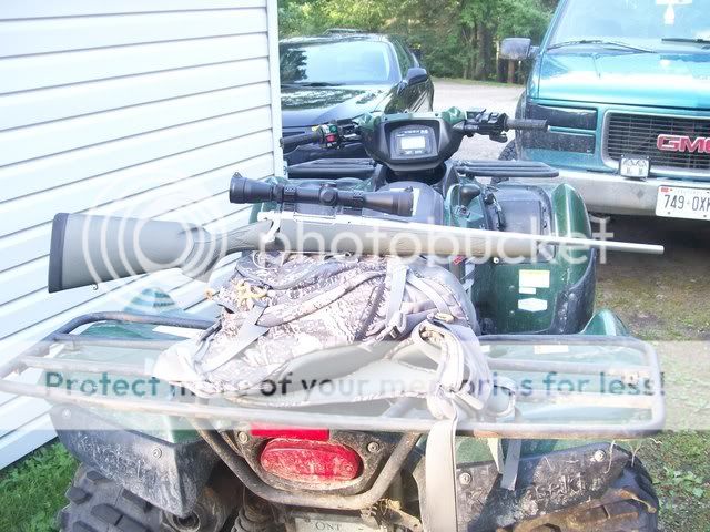

Hunters edge will be the lightest, and has a shorter forend, so would suit the shorter barrel best.
RMR has less drop, cheekpiece, and longer forend. M7 pattern has the Schnabel tip.
Id go Hunters Edge, with a 1" pad.
Hunters edge or M7. I had a RMR on a m7 and it looked stupid. As Blargon mentioned it has a longer forend and it looks out of place on a 20" tube. That and the shape of the cheek piece is ugly. My $0.02
I had an EDGE RMR on a 260 M7, and it just wasn't right for a 20" pipe. Leave the RMR for 22-24" barrels. The Model 7 stock just sucks plain and simple. The grip is like a banana, which is great if you're Rem338Win, he'll just slap some mayonaise on it and he'll feel right at home.
If I were doing it all over again I'd go with the compact.
