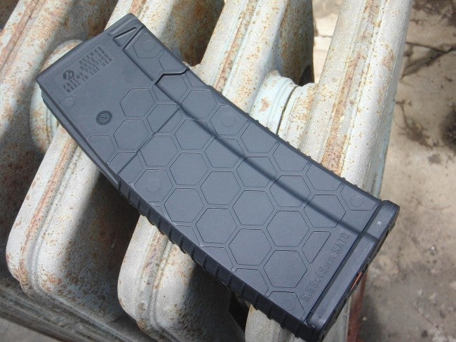

I think HexMag are working on a 308 mag. And they are looking for dealers.
Heard good reviews about them as well. Maybe worth a look Rick.
w ww.hexmag.com
