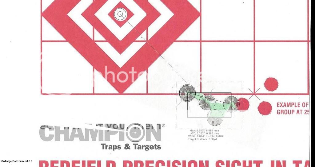

I'm sure you won't accept my groups from my own personal rifle, but your comment saying there are multiple bad groups, and only one good group is quite different from everything that I've seen and heard. My handloads are still in development, currently I'm trying to balance a load out with a solid reliable crimp. Things are looking pretty promising though. The factory ammo was shot from a clean barrel requiring fouling on a 5 target sheet, top right(cut off from scanner), top left (also cut off from scanner), then center, then bottom left then bottom right, then took it out to 200m.
So, handloads:
168gr Amax
165gr SST
Factory Ammo:
Federal Gold Medal Match 168gr SMK
@100 meters
@200 meters
So, handloads:
168gr Amax
165gr SST
Factory Ammo:
@100 meters
@200 meters
Great shooting, I'm not trying to say the rifles are pieces of crap, they are far from it. I just expect them to all shoot like that. There are lots of range reports on this forum, most of them are pretty dismal IMO for a 4-5K rifle. Maybe most people that have bought them aren't precision shooters?
The more good range reports I see, the more likely I am to buy one. But from what I have seen, a very well tuned (and lucky) norinco M14 will almost keep up with them. For under 1000$
