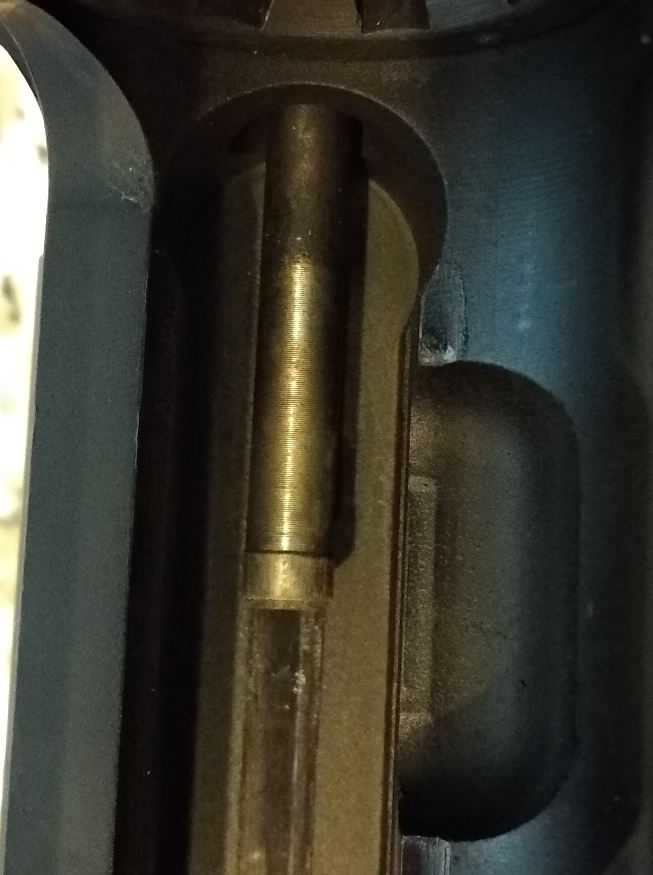

Since both of you have TNA gas tube... I wonder if the tube seals gas enough at the gas key interface.
This is something I never thought of. As a test I took everything (firing pin, cam pin and bolt) off the BCG. When I slide it forward into the upper receiver and onto the gas tube there is no extra resistance when the gas tube begins to slide into the gas key. Is this normal?
Also though maybe checking the length the tube protrudes into the receiver might be a good idea so I took this picture:
Does the length look correct?
EDIT: I also note that there is a lot of carbon on the gas tube closest to the front of the receiver, but very little where it would be inside the gas key. Is this normal?
