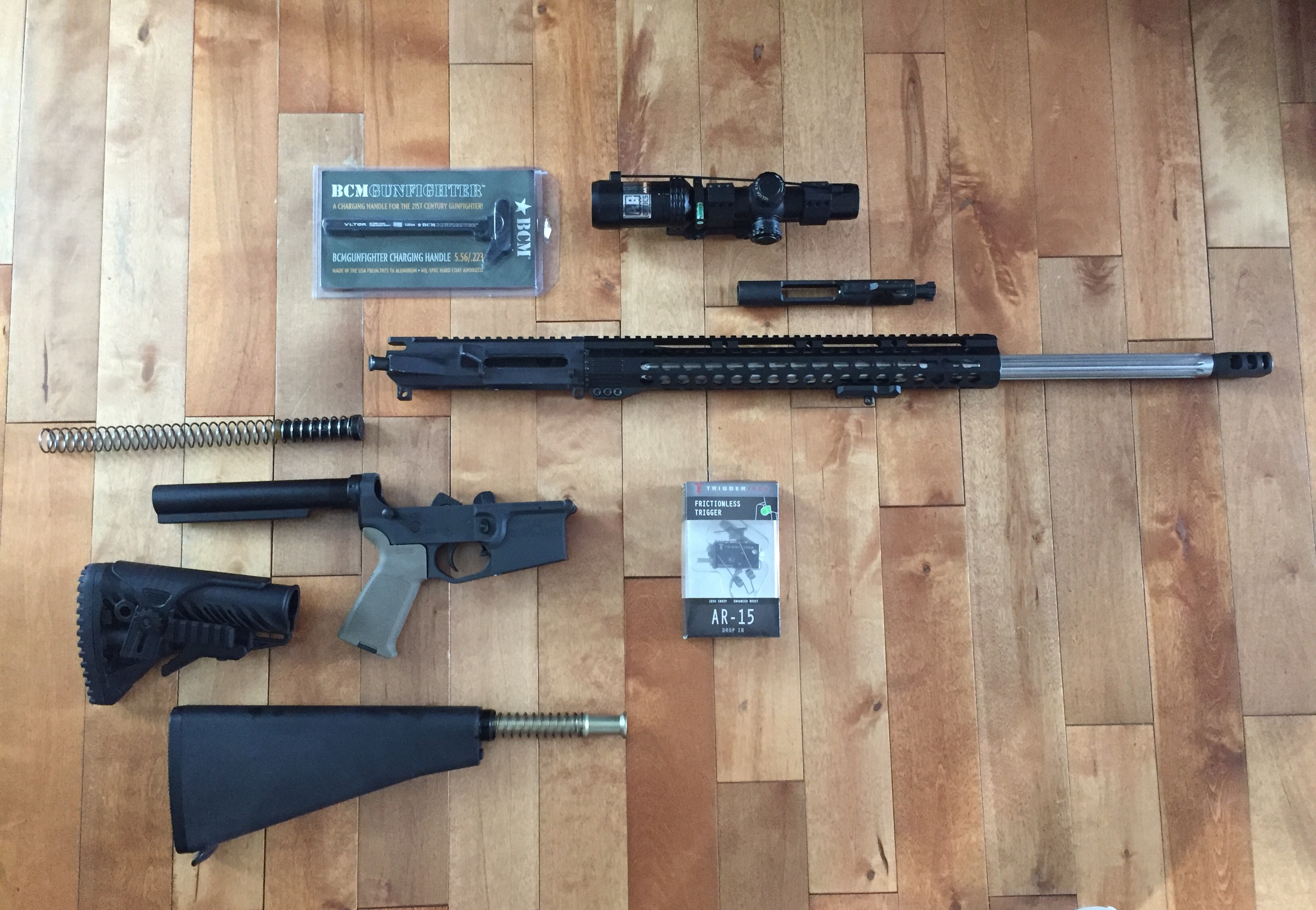

My build:
Ordered 2x uppers, both slick side.
1 will be
- .223 wylde using a Rock River Arms 24" fluted stainless varmint barrel
- Magdumps 15" keymod lightweight handguard
- Bushnell AR 1-4x24 scope in a ADM/Vortex QD mount
- BCM Gunfighter charging handle
- spare BCG I had... unknown brand, with Colt bolt
Lower will get completed with
- Daniel Defence LPK (gutting it out of my NEA AR15 lower)
- Triggertech AR15 trigger
- Spikes polished buffer spring and buffer
- Fab Defence GLR16 Stock
or
- A2 stock
The other will be in 7.62x39mm and using
- Brownells 7.62x39 BCG
- TNA 7.62x39 18.6" barrel
- SLR Adjustable Gas block
- and undecided - but another lightweight HG; either TNA, or Magdumps again
