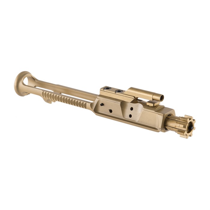

What do you think about the brownell BCG? I want to order one TiN BCG but not sure about the quality.
Ive had 3 different brownells BCG's in the last year and never had issues with any of them. So I dont think this one will be any different. The Fit and finish on this 99$ bolt puts some more expensive one to shame.
The are manufactured by Toolcraft and have a lifetime warrenty. Last time I had to deal with Brownells for warrenty, it took just 1 email and they shipped out the replacement part for free and told me to trash the old part.
