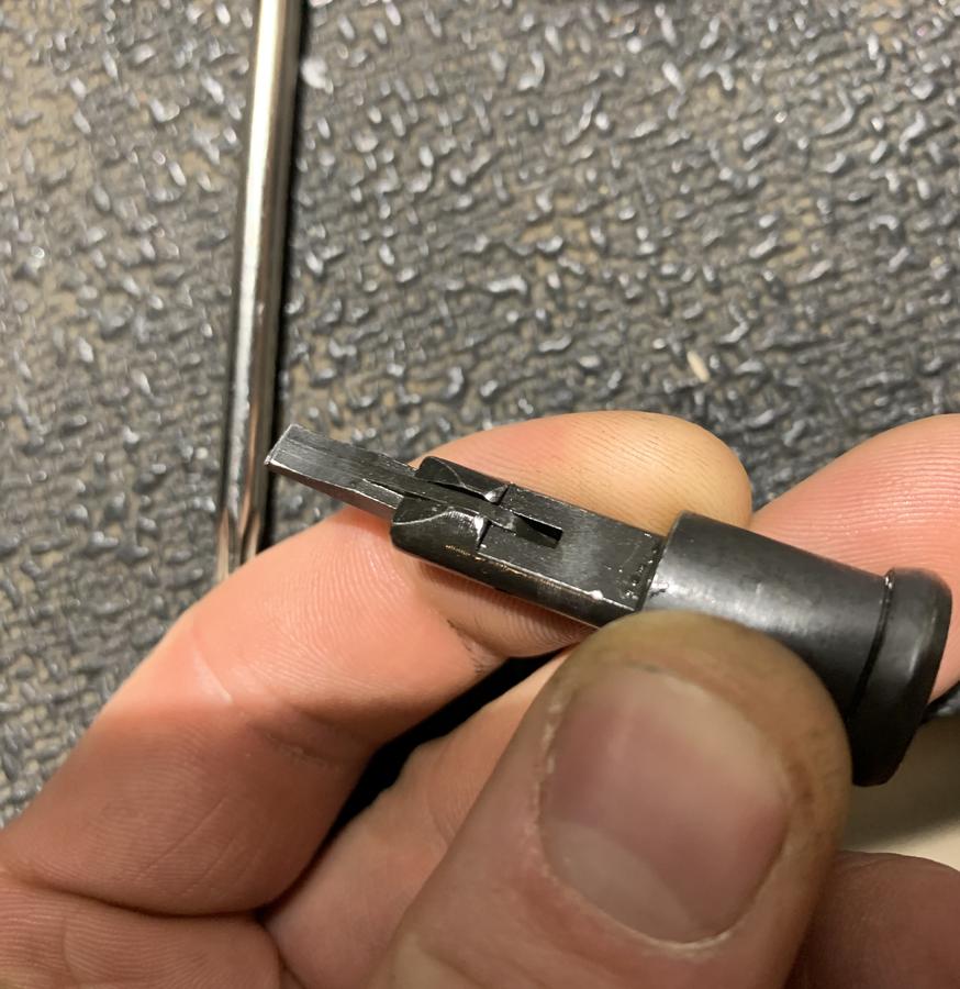

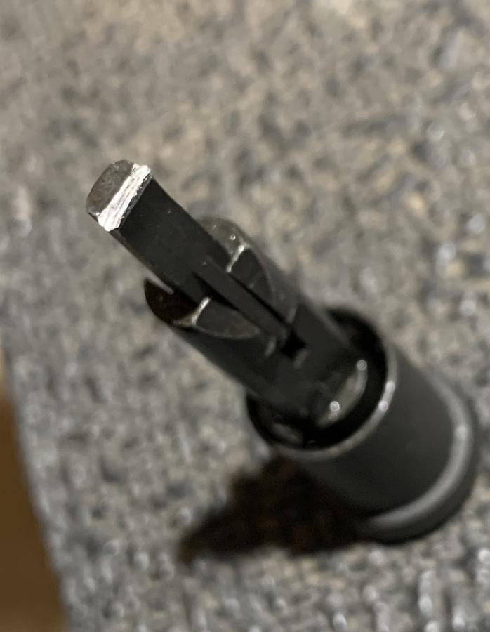

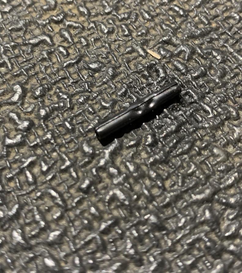

So first trip out with the sporter, second mag, third round, she locked up solid. Shot sounded funny and felt funny, tried the charging handle, mortared it, still locked up. Noticed the FA was stiff and would not move, got out the tools, knocked out the FA retainer pin and finally it let go. Seems to me like the FA caught the BCG under recoil, it did not catch at all when I racked the rifle after assembly, and I can assure you it was racked many times. Forward assist (standard Mil-spec) was chewed up on the end, pin had 2 neat dents in it right in the middle, and there was cleaned off metal at the end of the notch for the retaining pin. So I left it out, gave it a once over and ran it for a few more mags. No problems there. Anyways, I just thought I’d reach out and see if anyone else has had issues like this, is there a FA that works better? I tried the one out of a spare stag 10 upper I had (that threaded retaining pin is much easier to deal with than the roll pin) and it seemed to protrude further into the MS than the stag upper when felt at the pawl end of the bore, it took very little pressure to get the pawl to catch the bolt serrations. For now I’m knocking the pawl pin out and I’ll have a Faux’ward assist, but any info or experiences from the hive mind would be appreciated. I’d really rather not send it back! Not yet anyways.

What’s different on the Stag FA other than the retainer? It’s the same length, width, etc as the one in the picture? The stag one looks a bit higher quality in some ways but other than that seems identical.
