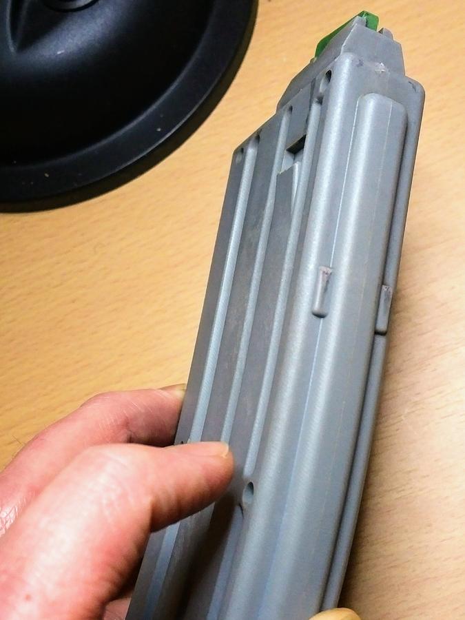

Anybody have fitment issues with CMMG .22lr conversion kit? The mag has a couple tabs about 1.75" from the top that impede it from being inserted all the way.
Nope, can't say I've seen or heard of anything in relation to that. Could you post a picture for clarification?
I just bought the kit used (from a reputable CGNer), but just realized it doesn't fit in my AR mag well either.
