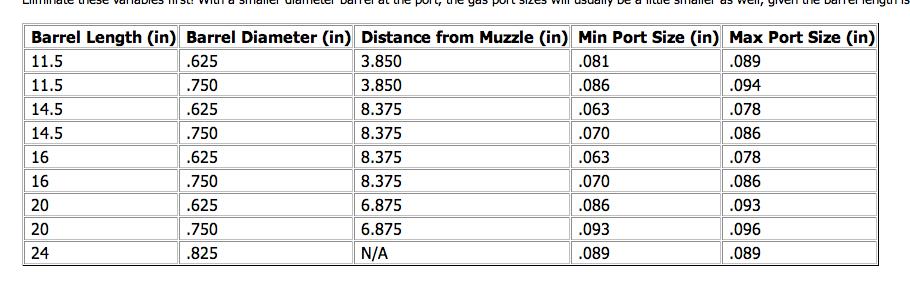

That .99 is very large for a rifle length. What diameter and what is the OAL of the barrel?
18.6" barrel and 0.750" gas block.
I couldn't actually find solid info on gas port size for 18.6" barrels, but did see mentions of 0.098" for 20" barrels, even some random internet forum comments about up to 0.109".
Rifle works now with a non-adjustable gas block at the moment. I'm no expert, but it sure doesn't feel over gassed and was ejecting nicely at a 3 o'clock position during my test firing.
