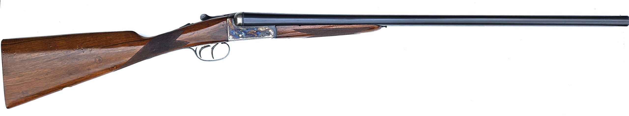

Hey folks, looking around for a modern SXS manufacturer. I see Cheap stoegers and want to spend more money than that. I would like a "nice" SXS. something light, quick handling, good pointing etc. Pretty is nice and all, i would like to be proud of it, but I know It's going to get banged up in the brush.
I'm not looking for a super fancy 5-20K firearm, I think that's a little rediculous for my lifestyle. I would expect to pay 1000 to maybe 1500$ for a lifetime keeper gun, but maybe that's not realistic?
20 gauge is my favorite gauge, but I enjoy 12, 16, 20, and soon to be .410
It's mostly going to be used for upland bird. Pheasant, maybe ruffed grouse. might get used on a rabbit or something here and there. I was hoping for 16 gauge as I don't have much in 16, and heard it "hit's like a 12, kicks like a 20".
You experienced claybusters and bird blasters have any opinions or advice to share? or anyone know of good modern manufacturers of SXS? If i HAVE to..i'll look at O/U but really love SXS.

I like Churchill. Good gun
Years ago (20+) I hunted a lot with 3 friends. Mostly grouse and woodcock over dogs. Each of us had 20 ga Ithaca/SKB's SxS. All of us loved them. Mine had 28 in barrels and chocked M&F. The other 3 were 25 in ImpC/Mod.. Mod 100's if I remember correctly. They occasionally still come up for sale. A couple years ago Switzers Auction sold one. No idea of value now. Paid $500 for mine in mid '90's.
I've had both the 25" and 28" SKB M100s. The 28" is a better handling length. I bought mine with the chokes opened up to IC/M. It's perfect.
They are not $500 anymore but still a very good field gun at twice that price. The only thing I don't like about it is the lack of two triggers.
My sentiments exactly.
I've had 2 M100's and an M200, the 200 had 25 inch barrels and the 100's were both 28 inch and one was 12 gauge while the other was 20 gauge. It wasn't many years ago when you could get really nice ones for under a grand. Those days are long gone but still, I'd definitely recommend one if you can get your mind around the single trigger.
You can still get a very nice 16 gauge Huglu sxs from Prophet River. however once these are gone you wll be SOL, since Prophet River is no longer importing Huglu shotguns for some unkown reason. I have had a number of them over the years, since CZ shotguns are actually made by Huglu and currently have a Huglu 200AC 12 gauge which is the nicest shotgun I have ever owned.
I just bought a 202B Mini in .410 from Prophet River, I didn't realize they were no longer importing them. Glad I bought mine when I did, I'm really enjoying it so far.
I'm not really a shotgun guy, can't get excited about them the way I do with rifles. But I have a lovely old Brno ZP49 SxS 12ga double trigger that has been in my safe for about 30 years. A true sidelock gun that even today can be had for far less than $1000. Had it reamed out from M/F to IC/M and a rubber pad installed. It is lightweight, handles beautifully, and looks the way a SxS should look IMHO. I think these guns are one of the best bargains in the gun world.
Steel shot? Beats me, but I doubt it; I will never want to use steel in it so I don't care. I have butt-ugly pumps and semis if I need to shoot that stuff. Fixed chokes? Yep, for me it's a pure upland gun and they work. If I had to find something to complain about, it would be the fact that I once had a pair of them and stupidly sold one.
I love this gun, but again, I'm not a dyed-in-the-wool shotgun guy. I recall hefting the Brno in one hand and my Husquarna SxS in the other, and being blown away by the difference in weight and feel. The Husquarna got chopped down and equipped with iron sights, to become my Poor Man's Big Bore Double rifle. The Brno will live forever as my Upland Gun.
If any shotgun experts want to enumerate all the things that are bad about the Brno, to warn the OP about getting one, I look forward to reading what they have to say. For me, it won't change my mind. :)
