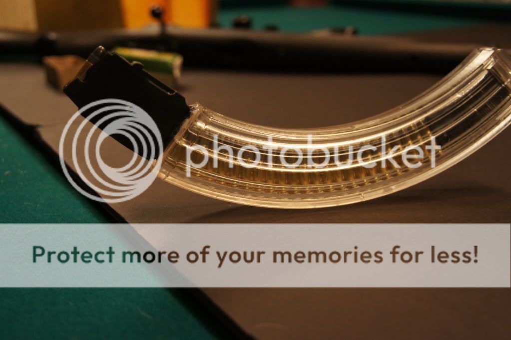

Allow me to introduce the Kevin M. one of a kind special 30 cartridge bolt action rimfire magazine.

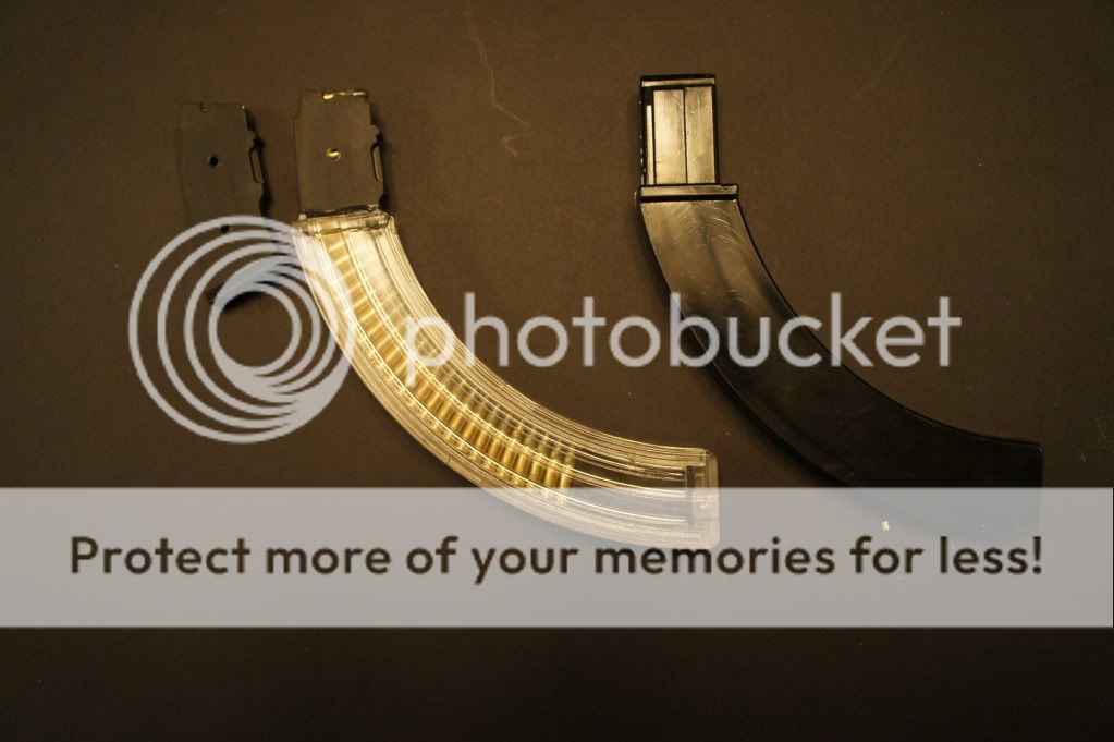

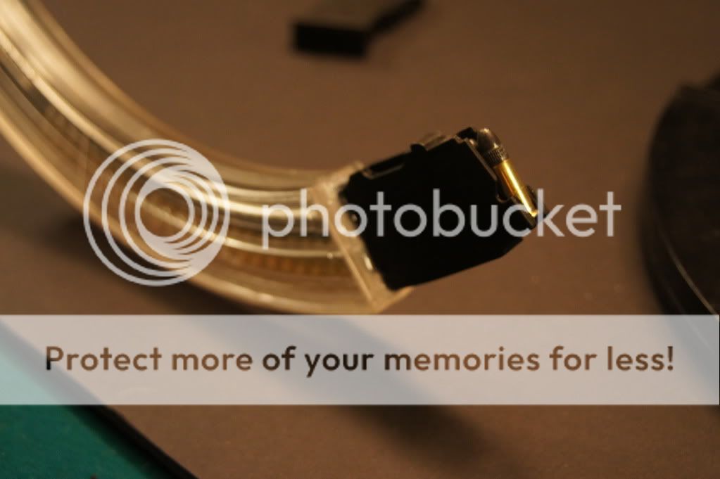

Function tests have run flawlessly after a bit of carful filing on the inside of the magazine to smooth any excess superglue with jewlers files, and some prior work on the mini-mill to do the bulk of the precision work.

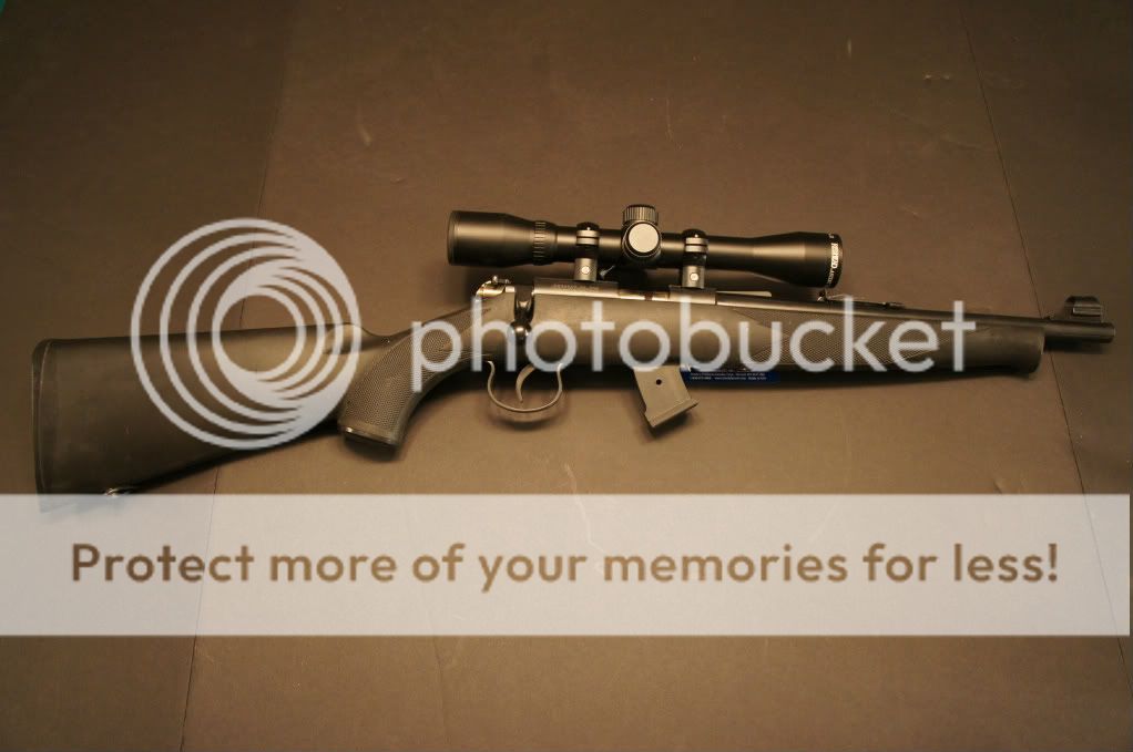

The rifle with the 10 round polymer magazine.

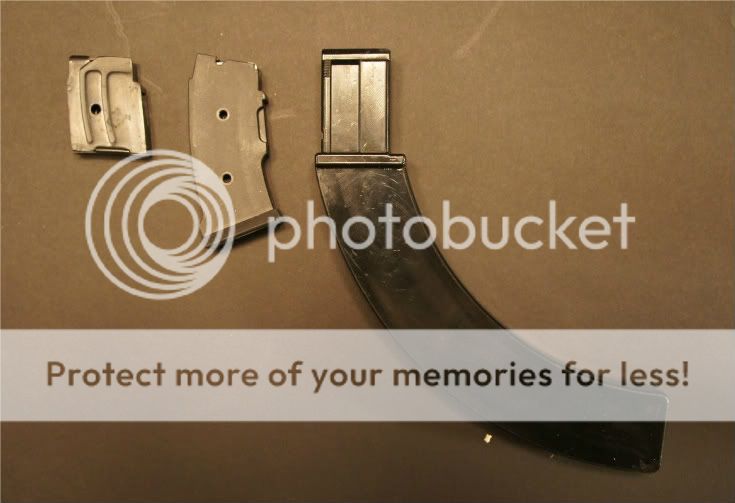

The magazines, from left to right; Factory 5 cartridge metal magazine, aftermarket 10 round polymer magazine, 30 cartridge Remington 597 bananna magazine, for which a clear version was the donor for the project.
The finished magazine next to a 10 rounder and a stock 597 mag.
The feed angle is near perfect, within about a 1/2 degree or so of the factory magazines.
The rifle with the (empty) mag inserted.
