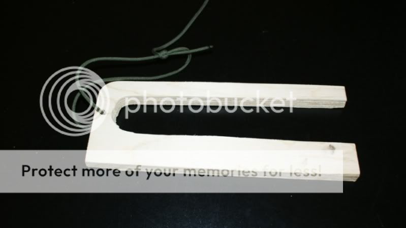

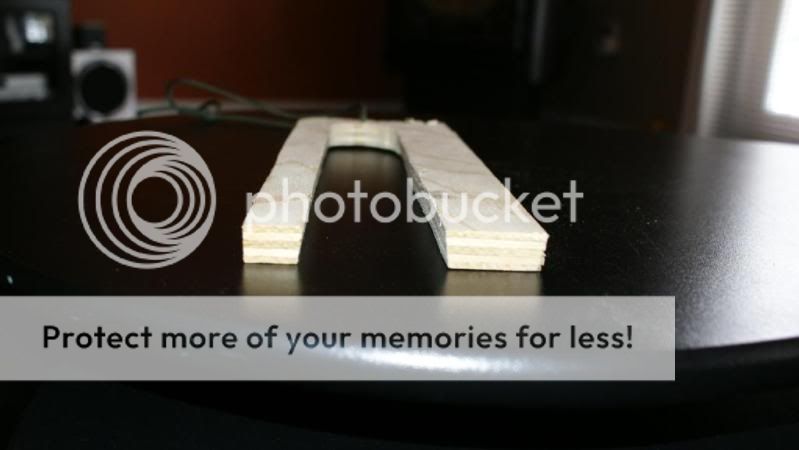

Would you happen to have plans for this hand guard tool drawn up? I am going to start trimming my MOE hand guards, but I'd like to see plans for anything which would assist in the process....
Here is a video that shows you how and some pictures of mine made out of 1/2 inch plywood.
I did a 5 degree on the cut as seen on the second picture to contour the ring.
http://www.youtube.com/watch?v=7IX0BvPW2uI
Hope this help
Gaetoune
Hope this help
Gaetoune
