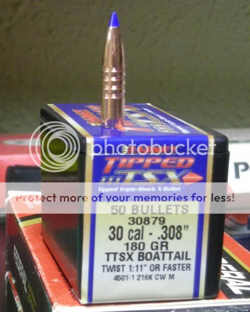

Always good results using Barnes X bullets. For my .300 Win. Mag. I load the 180gr T-TSX bullet at 3050 fps MV -
Sako 85 Grey Wolf .300 Win. Mag. with Nikon Monarch III 4- 16 x 42mm scope
