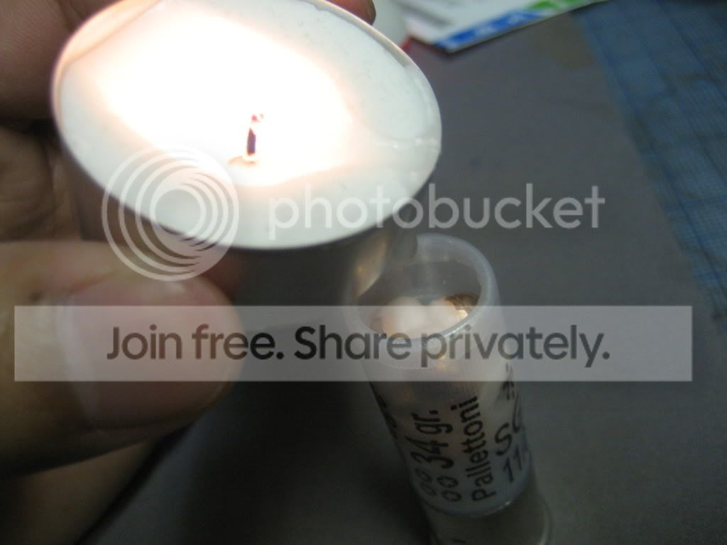

I experimented by filling buckshot with melted wax. The groups were way tighter but nothing close to your results.
