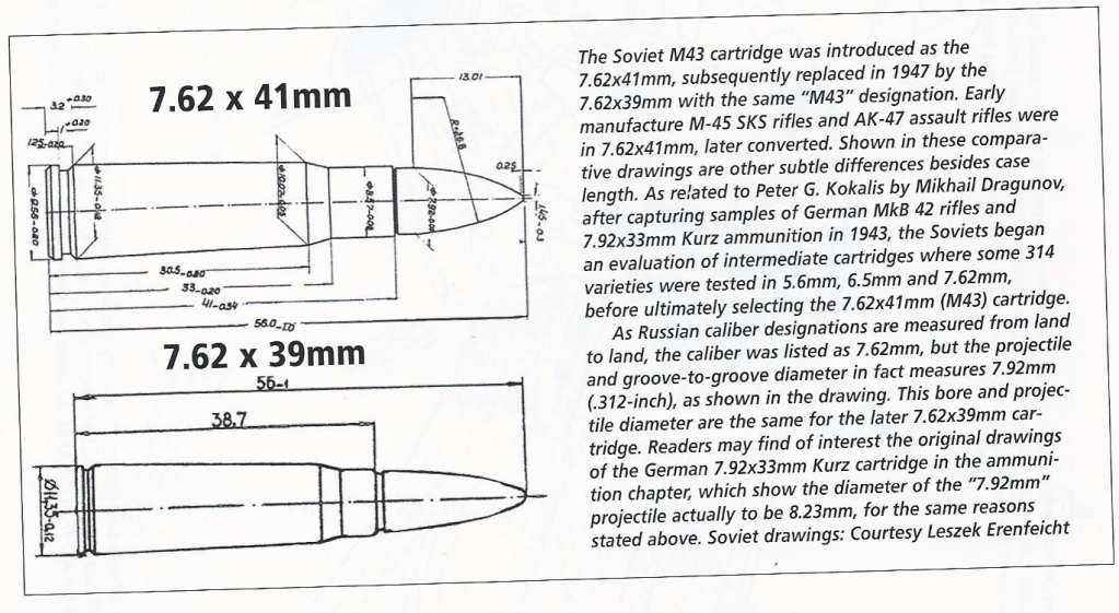

Are you sure that it is in 7.62x39 M43 round? The magazine looks to me like the pictures of the early prototype SKSs I have seen, and those were in the earlier prototype 7.62x41 (or x43 I can't remember) M43 round.
Yes I should've said M43, as I don't know if it was in 7.62x41 or in later 7.62x39. Soviets called both just M43.

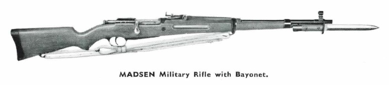

Beautiful rifle. For some crazy reason, probably the lines of the stock etc, she reminds me of the Madsen post WWII bolt action rifle that went nowhere.
