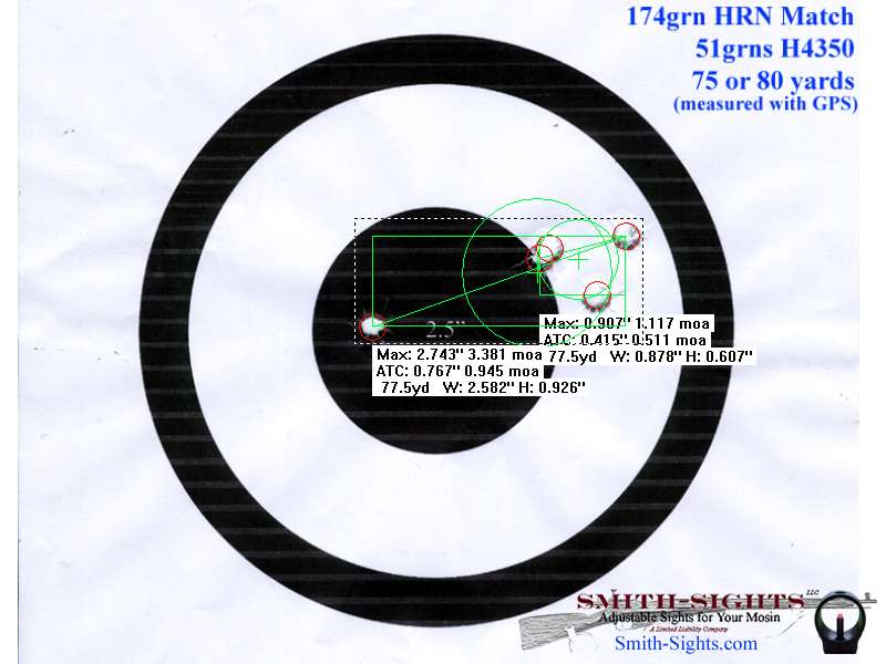

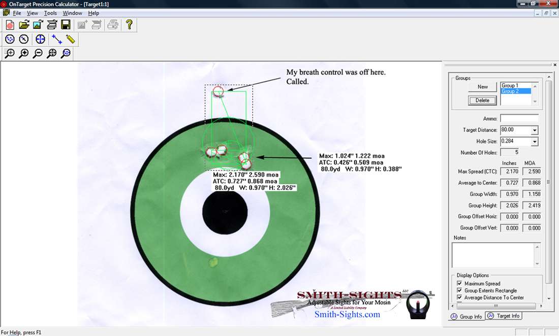

I haven't properly shot and measured my (non-reproduction) PU Mosin, but from very casual shooting, it has gotten a solid 3 MOA, though the barrel on mine looks barely used and well preserved.
