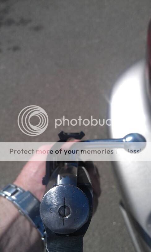

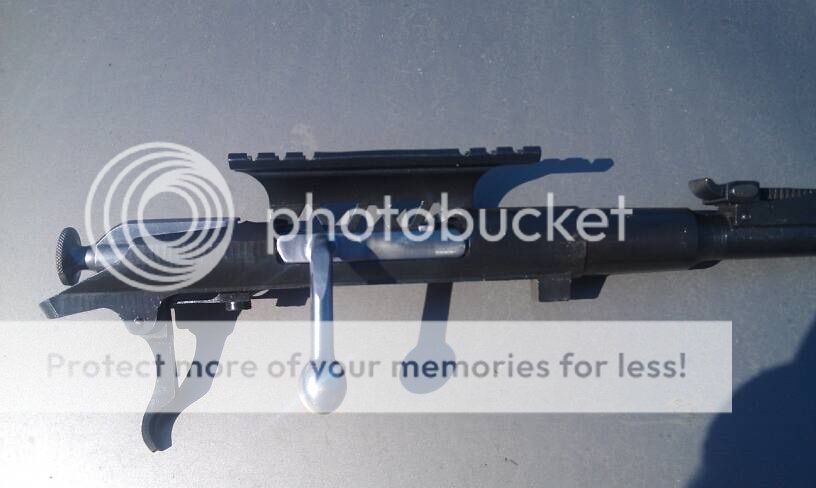

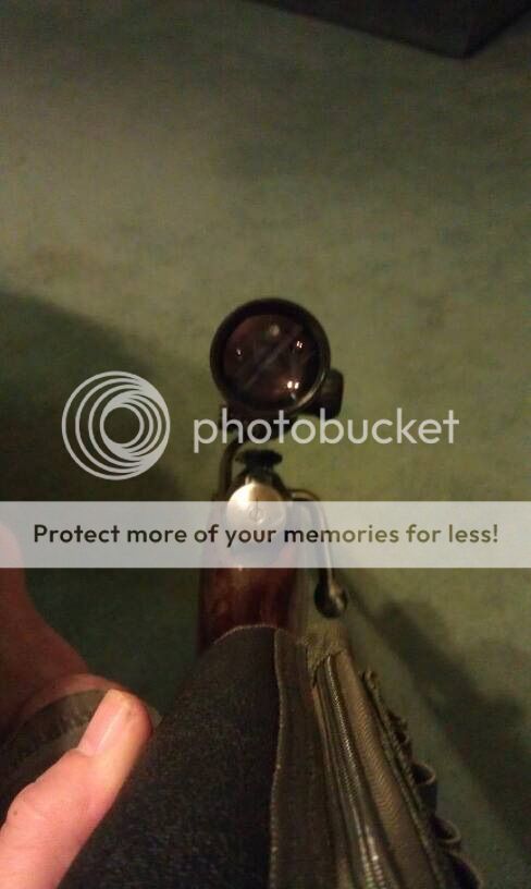

One other idea I had was to use the Choate or similar promag sks mount and after doing a site and web search found these over on some other forums. Anyone with a Choate mount think it would hold up on a Mosin and the x54r round? It will allow the use of irons and require minimal grinding of a stock bent bolt which I already have, everyone seems to give it good reviews on the sks.
Both are a lot cheaper than the Trueshot or RSI and will not have any real bolt clearance issues unlike the RSI mount. It might be a bit lighter than the True Shot seeing as the Choate and Promag mounts are a one piece mount.

It will work just fine. Use a semi-permanent thread locker (red) and torque the screws down well and it should hold.
