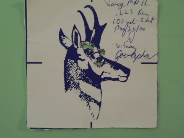

Ditto on the Savage for out of the box accuracy. You can get the heavy barrel with accutrigger for less than $1000.00. Add a scope and a bipod and you're all set. Here's my model 12 (pre-accutrigger:( ), but a beaut all the same. The target group is .75" at 100 yds. The top left hole is three shots and there are two others to the right. My scope is a cheapie Tasco target model at under $150.00. If I buy another target rifle it will be the same model, with accutrigger, in .308.
