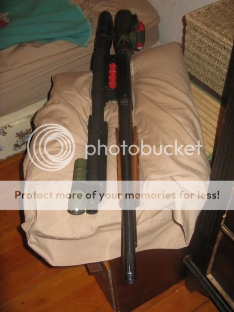

This is what I ended up doing with the streamlight rail.
It was designed for the AR15/M16 and only requires the use of a drill press to install.
Parts as they were removed from bag
Positioned it on the front of a Remington "Sporting" forend that I had cut down to clear my TacStar Sidesaddle.
Side view of mount showing how I positioned it on the "straight" portion of the forend.
Drilling screw clearance holes.
Inside shot of drilled holes.
Snipping the aluminum retaining plate allowed the threaded inserts to pop out.
Drilling out the holes from the inside to hold the threaded inserts.
Testing the depth for the first insert. Looks like I need to go deeper.
Checking magazine tube clearance.
After shortening the screws by a 1/16" of an inch and adding epoxy to hold the inserts in place she was good to go.
Note - I would do it again on a full size sporter stock as the added length allows me to grip the forend better. The shorter version doesn't allow me to get a comfortable grip on the forend after the flashlight is added.
