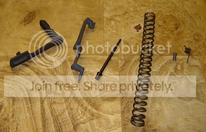

Can't ehlp you much, this is as far as I've gone...
I would assume that the pin goes out from L => R...
If you ever lose/break springs/firing pin and the likes, let me know... I somehow ended up with some spare parts.
Safe shooting,
Mike
