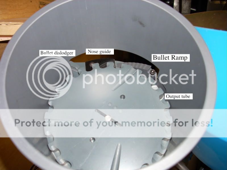

I just recieved and set up a new production Mr. Bullet Feeder for the Dillon 1050. These were previously marketed as the KISS bullet feeder.
The instruction manual is about a dozen pages, with lots of decent pictures showing proper and improper installation. In truth, the instructions are almost overkill, but in a good way. Rick goes out of his way to explain not only the how to, but the how come.
With everything unpacked, set up took less than 20 minutes. The bullet dropper requires that the powder measure be removed, but the installation is easy. It's literally as simple as screwing it down until the bullet drops into a pre-flaired case, then 1/2 turn more.
The collator is installed on a bracket attached to the casefeeder now instead of the bench, and the spring that connects the collator is then attached to the bullet dropper.
I loaded 400 rounds last night, and not one single problem. I'd been worried about flipped bullets or bullets tipping over while moving to the next station. Not a worry at all. The weight of the bullets in the column tamps the bullet into the case with enough force that it won't come out without some effort.
