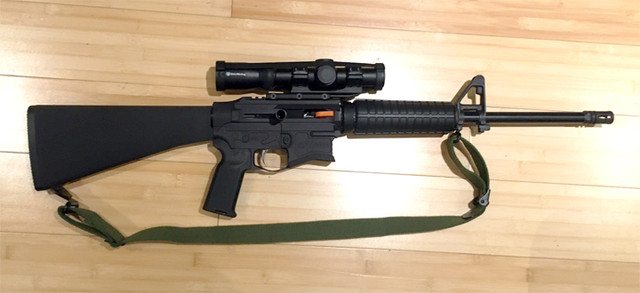

I grabbed one of these and put all my AR parts on it and it’s a great little shooter. I’ve been telling everyone about them. And local too!,
Happy with mine. Got to use those random parts that were just laying around. Made a straight pull 7.62x39 fun blaster.
