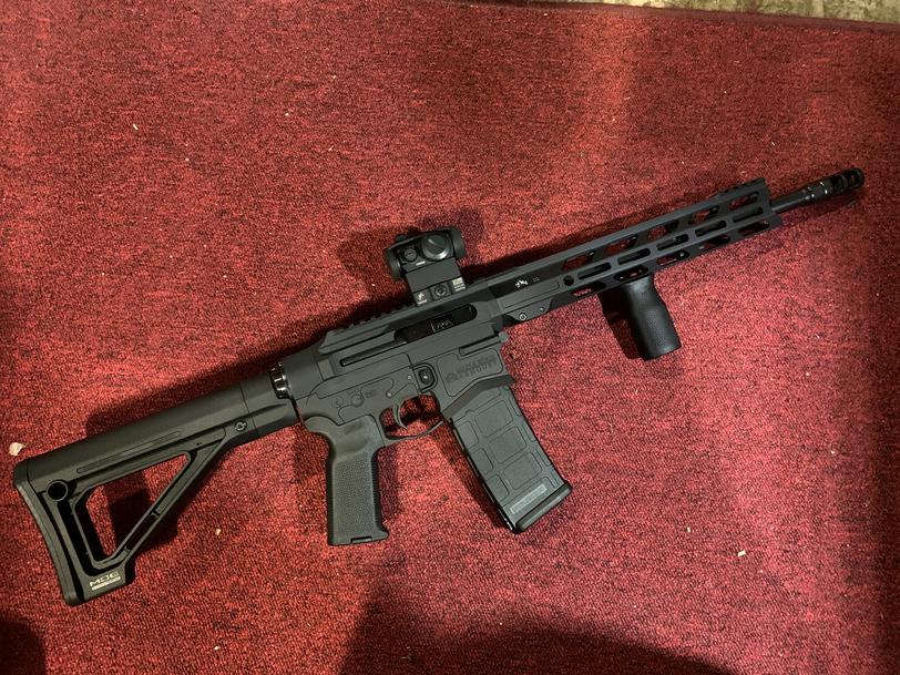

Here’s mine. 13.7” ballistic advantage barrel, mra hand guard, mra brake, magpul furniture, mil spec lpk. Haven’t shot yet, but I love it.
