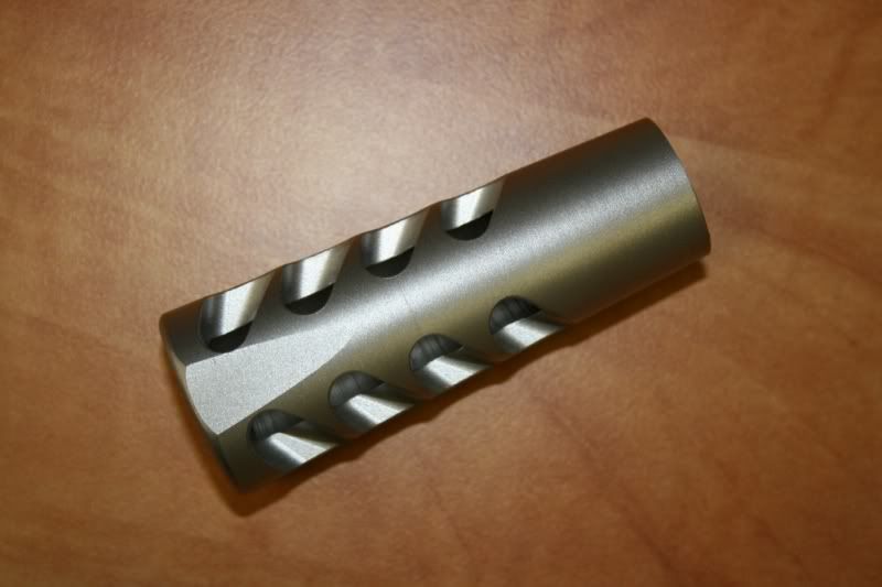

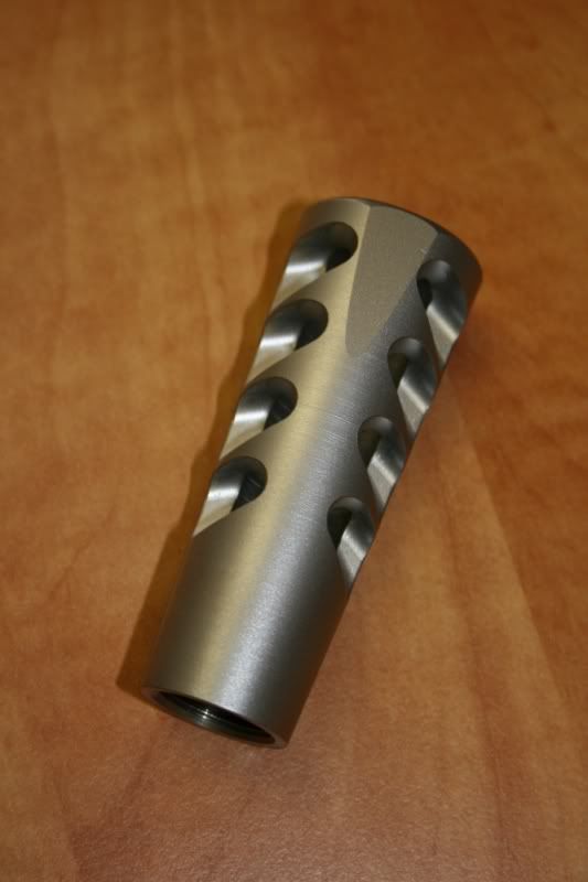

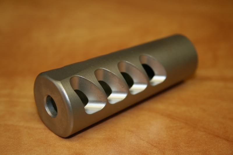

If you are not crawling in the dirt when you fire your Sendero it does not really matter if the brake is ported all around.
This top brake in this picture is on a Sendero and finished flush because of the large diameter. It does work very well. If you are wanting the tactical "look" and no bottom ports then it isn't the brake for you.

Rick.. What is the diameter of that??? Can it be installed on a 1.125 barrel and look like an extension of the barrel with no taper I guess is what I am asking???
Being as we make each brake custom for the barrel it is being fitted to, YES
Currently the largest diameter bar stock we have on hand is 4" so unless someone is shooting MUCH bigger guns than I am we have you covered.:D
They look good Rick... the top flat can be used for leveling on installation and a wrench on both flats for tightening...
