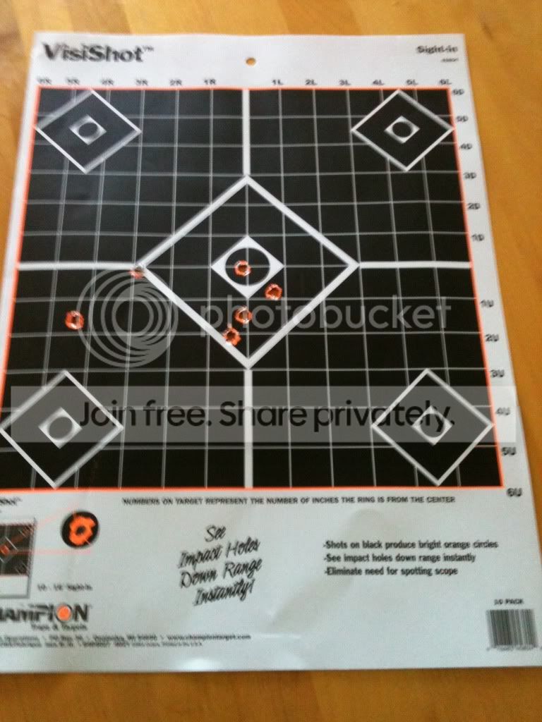

this is a pics of the first time i shoot with the 7mm rem mag in question. i first shoot the 2 on the left to see how it react. i reload and shoot the 4 in center with the original recoil pad witch was more esthetical then absorbing. as you can see, it's not a question of accuracy or "be afraid of", i'm really asking this for comfort. and again, as i said previously, i changed the recoil pad but did not get the chance to shoot it after. maybe it will be a lot different now.
For hunting, that is acceptable accuracy out to 200 yards or so. keep at it and you will master the tool.
