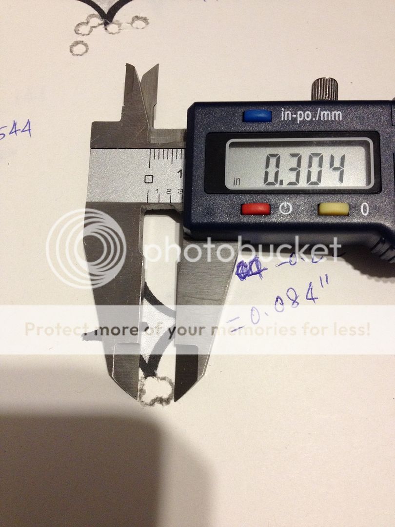

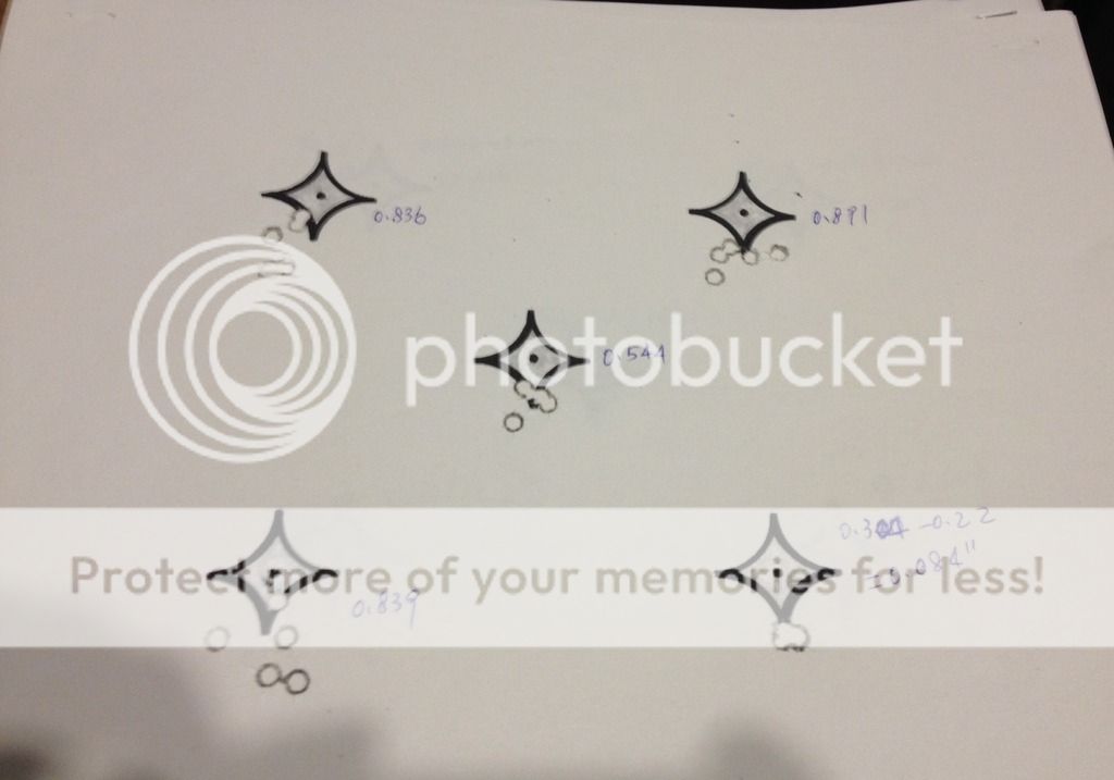

Tried this again today with a different rifle. Stiller 2500X, Benchmark barrel, Leupold scope 45X. Lapua Center X. Temp was 27C and shifting winds, had to wait for lulls.
Group #1 - .444" - .220" = .224"
Group #6 - .383" - .220" = .163"
Group #7 - .393" - .220" = .173"
Group #8 - .379" - .220" = .159"
Group #9 - .375" - .220" = .155"
5 group average .175"

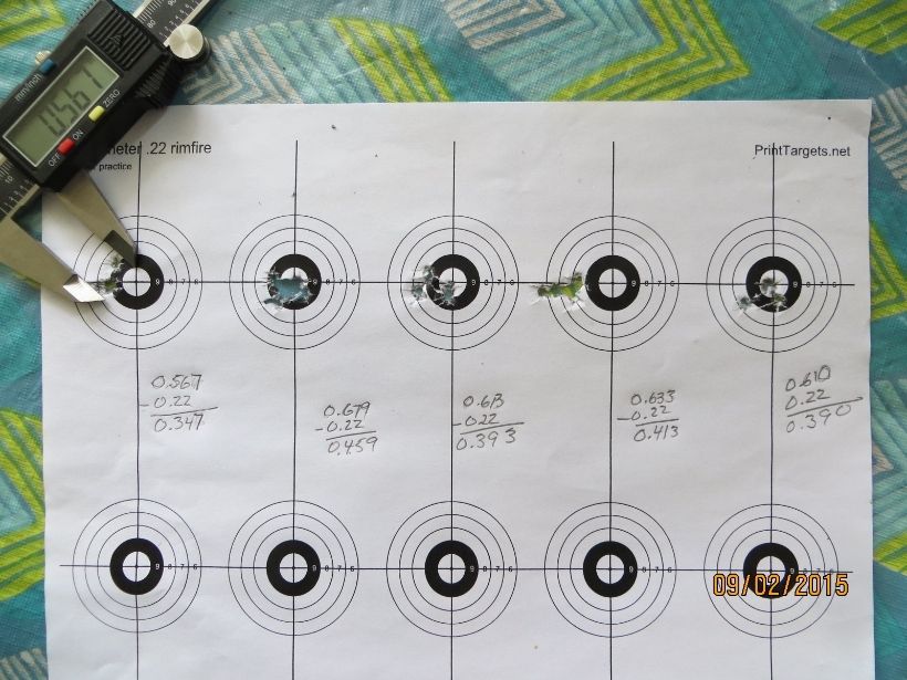

I hope I measured these correctly. The distance shot was 58 yards from muzzle to target.
L to R
0.567 - 0.22 = 0.347
0.679 - 0.22 = 0.459
0.613 - 0.22 = 0.393
0.633 - 0.22 = 0.413
0.610 - 0.22 = 0.390
Average group size = 0.400
Ammunition: SK Standard Plus
Rifle: Anschutz 1710 HB
Scope: Sightron 10-50x60
I shot this target this morning. I didn't begin by attempting to meet the challenge. I was testing ammo from a lot that I recently got and was shooting at a photocopy paper target. After the first three (L to R) looked promising through the scope, I realized that this target might be decent. The fourth bull's group is to the left because I began with a flyer to the left so I aimed at it.
