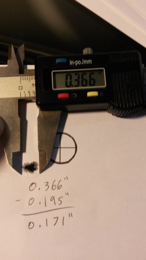

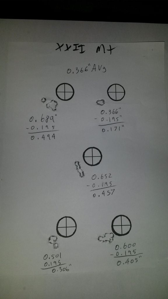

Alrighty, time to get this thread back on the rails! It was a crisp -2C with calm, 3-5 mph winds today. I was heating up a gel pack in the microwave to put in the cooler and keep my ammo warm, pouring my coffee and I hear this *POP* Oh crap! It exploded in the microwave after only 30 seconds! ARRRGHHHH luckily I read about Chilly using hot water bottles so I filled one up and used it instead (great idea). I recently re-barreled my Weatherby XXII with an Anschütz 1416 D HB barrel since I had determined after much testing the original barrel was just never going to beat this challenge. This target is a bit of a squeaker, but I am posting it anyway since I'm happy to finally get this rifle shooting proper. I haven't done any ammo testing or tuning yet so there's definitely room for improvement and hey, this was literally my first attempt at the challenge with the new barrel and I already nailed it :)
Weatherby XXII
Lapua Midas +
Vortex Crossfire II 6-18x
Caldwell Rock font rest with Narrow Sporter bag, Caldwell rear bag
Groups: 0.494", 0.457", 0.405", 0.306", 0.171"
Average = 0.366"

Well I sure jumped the gun (Haha :d) on posting an official result, my Weatherby XXII is one sweet shooter now! Feed it the preferred Lapua Midas + and she now gave me the challenge result of all 0.2's and 0.3's that I had been seeking, but unable to obtain with my MSR. Average for 40 five-shot groups with 8 different ammo types was 0.455", it don't get much more 1/2" all day than that!
