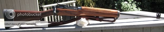

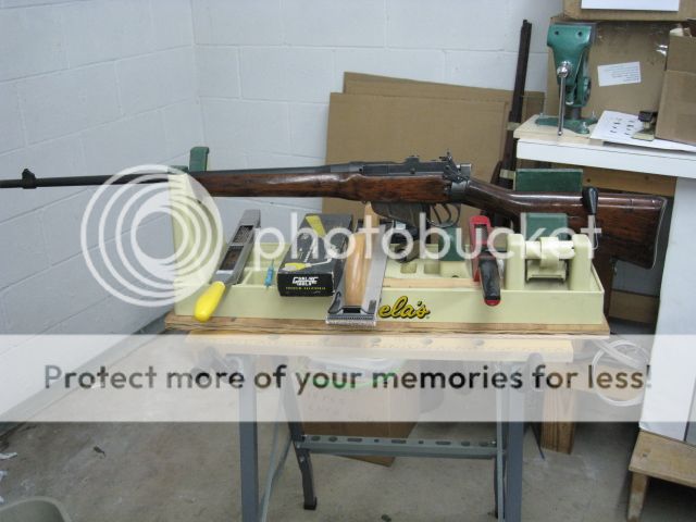

I started with this,,, which was the only #4 in the bunch, all the rest were #1's of varying ages. This was the newest gun.
When I got done this is what the gun looks like.

An odd looking build. Looks a lot like a L42A1. That's a Brit rifle in 7.62. Once you wrap your head around it, it's okay.
Points: that's what I was going for or more properly a L39A1. Originally I thought an L42A1 without the scope and cheek piece, but then I saw a pic of an L39.

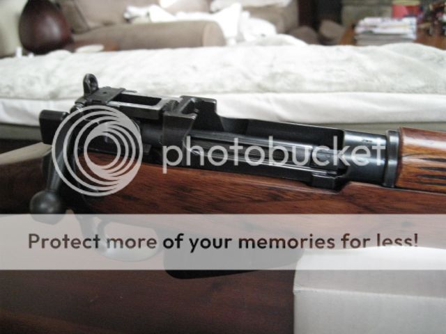

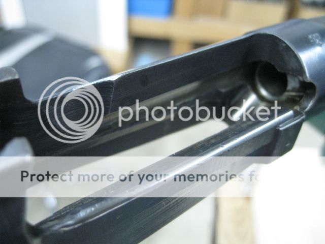

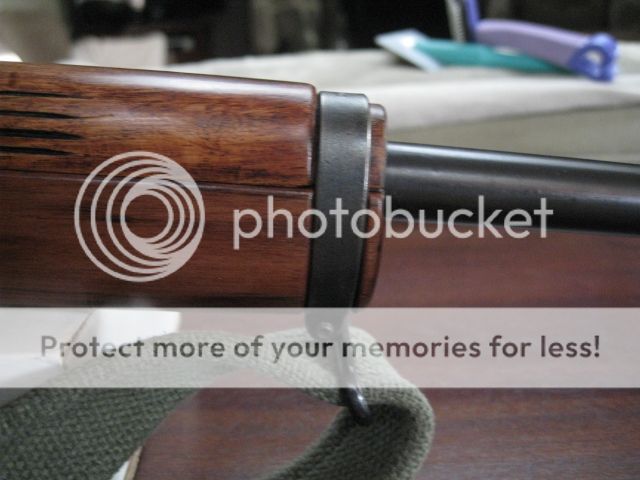

Nice job deburring and cleaning up the action; most of them would benefit from this, but it does take time and they were short of that during the war. You probably didn't need to round the inside corners of the sight ears because the sharp corners create a slightly larger bearing area for the backsight and are pretty much covered by it, if you see what I mean? If you use a sling when shooting or carrying the rifle you will find that the barrel band will tend to chip the wood on the outside of the band and the band will move around and ultimately probably pull off if the rifle is carried slung. The British left a good 1/2" of wood on the outside of the band to inhibit this. It still happened sometimes and the treatment was to scarf in a piece of hardwood to the end of the forend. A lot depends on the band being well-fitted and kept tight.

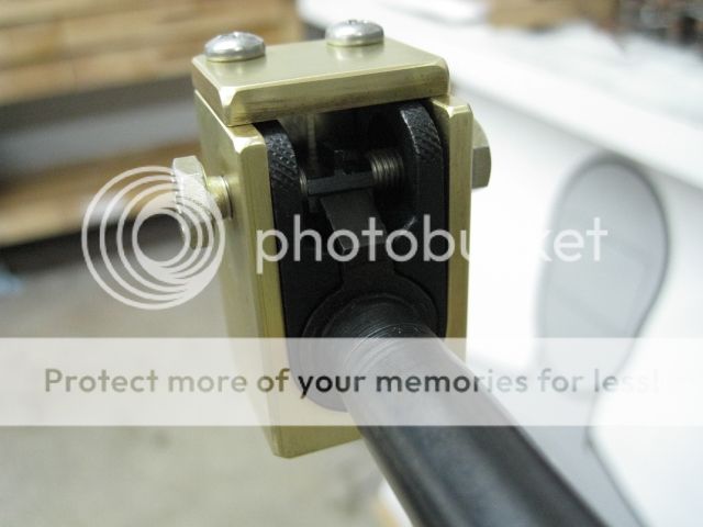

For your sight protectors you might want to use a steel/SS insert with a fine thread for the adjustment screws, if you plan to make the bodies out of aluminum. The originals had a fine thread for obvious reasons.
You may need to work on the bedding and barrel bearing to get the best results from the rifle. You can read up on the "center bedding" for the No4 online. Have fun with it!

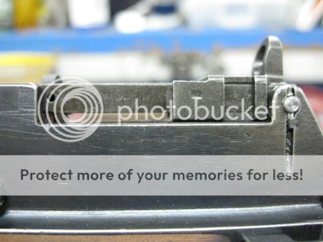

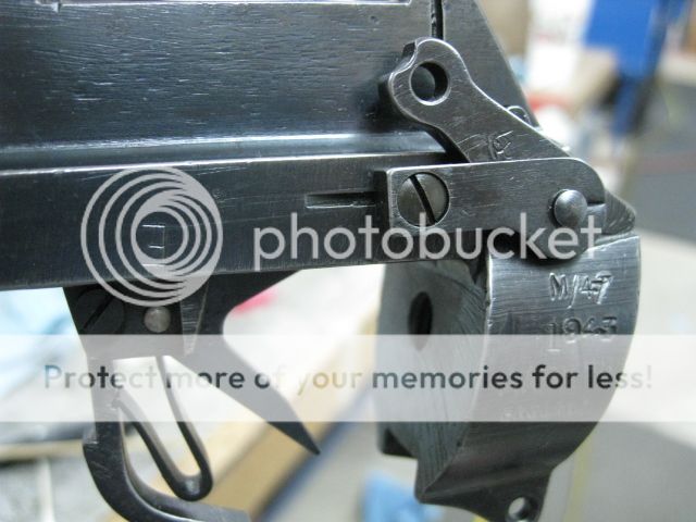

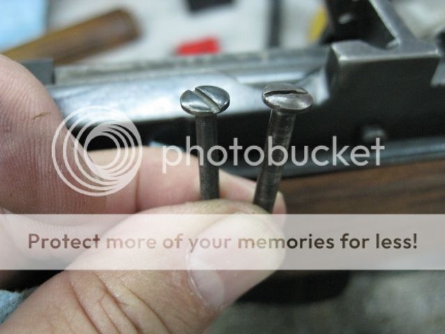

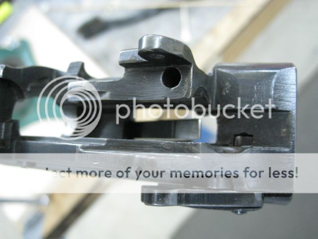

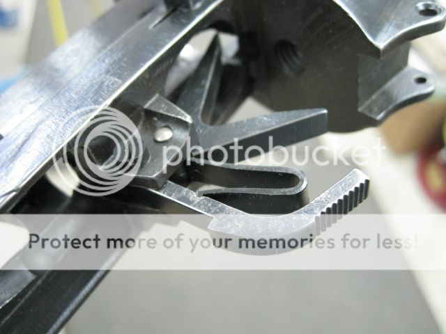

I got the gun home and immediately tore it apart. I saw nothing bad other than a distinct need for some TLC in the Deburring Department.
I took each and every part and addressed them separately. Every part got all the sharp edges broke with either a file or on the Scotch Brite deburring wheel, and then I reblued everything with Birchwood Casey Super Blue. It works pretty well.
After my bolt disassembly tool came I took it apart and cleaned the 50 year old grease out and broke edges and grit blasted the bolt handle. I then Reblued the whole bolt with the same treatment as the rest of the metal parts.
My new Mk1 Ladder sight didn't sit flat on top of the receiver, I did not want to modify it or the receiver so I used progressively smaller drill bit as pivot pins until the sight layed down like it is supposed to. The stock pivot pin is .145 in dia so I made one that is .125 in Dia.
The metal work was pretty much done at this point.

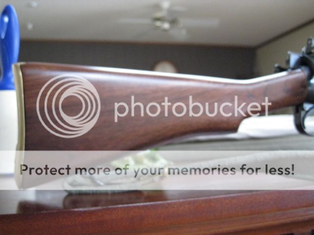

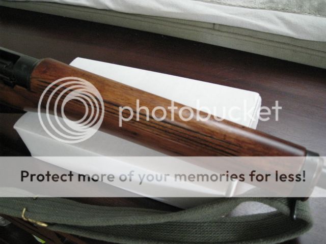

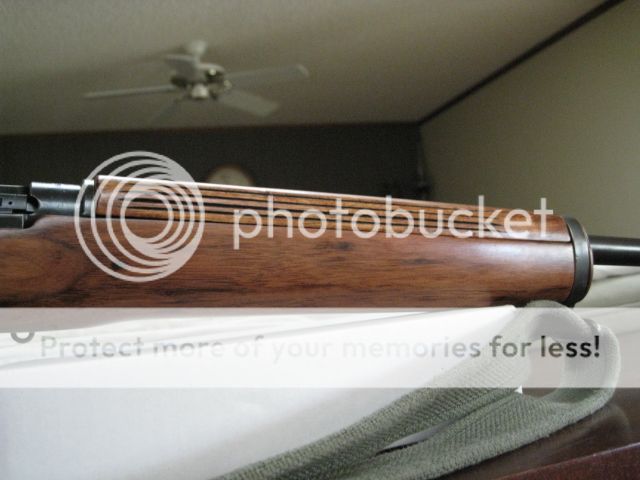

I had started on the wood earlier but stopped until I had the metal work pretty much done and I was waiting for parts to come. I wanted the gun to look like a L42A1 with the scope and cheek piece removed. I later found this to be pretty much what an L39A1 looks like. Point being I wanted a half stock with hand guard, as I considered this to be what a Classic Canadian Sporter looks like.
The wood on this gun had been painted with what looked and scraped like Spar Varnish. I literally scraped it off with a bearing file and my pocket knife. after that I attacked the wood with my finish sander and 60 grit sandpaper and removed most all of the severe gouges from the stock and fore end.
The Butt Stock was a nice figured Walnut I knew it would go to a darker brown color when finished. The Fore End was an Orangeish color but it still smelled like Walnut, and I knew it would never match the Butt Stock completely. The Walnut Handguard I thought I ordered turned out to be some kind of light hardwood possibly Birch or Beech, I definitely wanted the version with the 4 finger grooves on each side. I was able to get it to kind of match the Fore End.
There was a lot of trial and error staining followed by many coats of Tru Oil to get this finish looking decent. I wanted it looking nice,,, but not TOO nice.

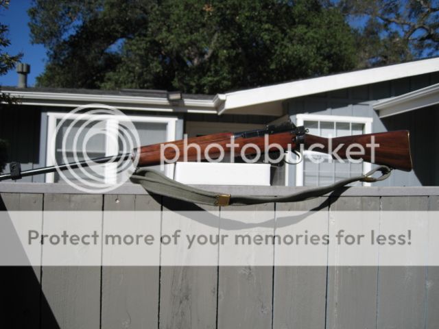

Here's indoor pics of what I ended up with.
Randy

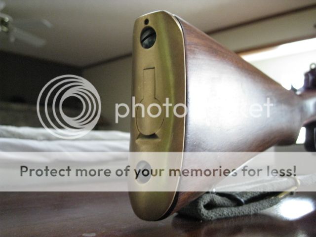

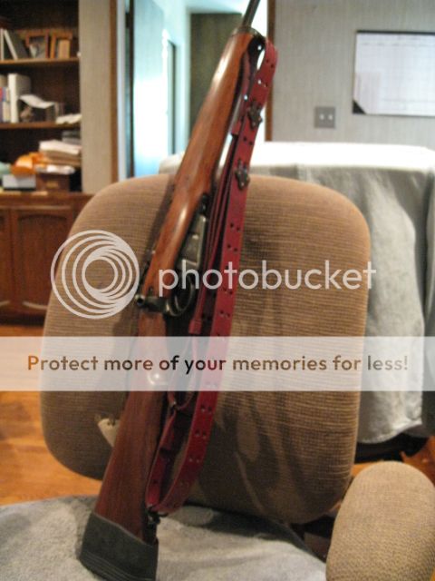

I decided that I wanted a different sling so I got a Brownell's 1907 Competition Sling and it came in as uncolored leather. This would not match anything so I got some dye and had at it.
The net result came out looking like this.
I also added the slip on Limbsaver recoil pad which turned out to be a very necessary addition. Walmart has these from $24.95 but I got mine from Bass Pro for $39.95 ,,, go figure. Walmart good.
Randy
