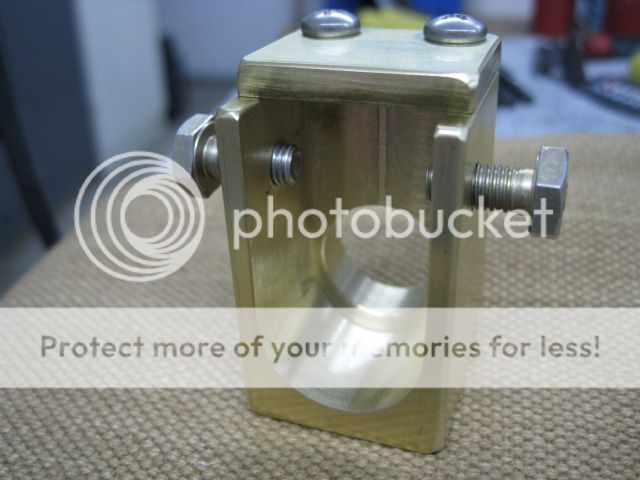

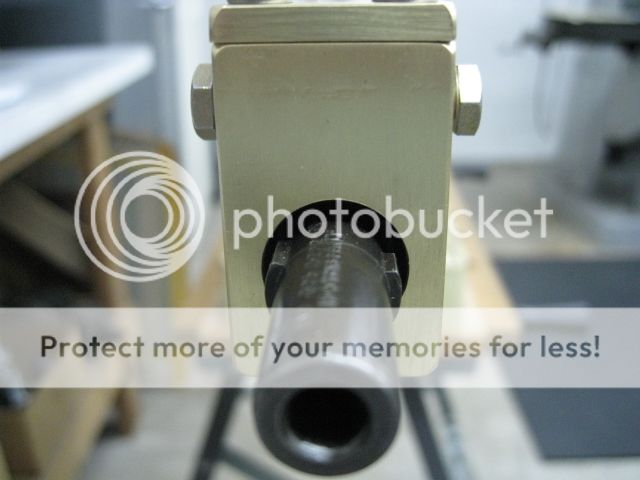

I realized that if I wanted to sight the gun in I would need a method to drift the Front Sight. I designed and built this tool, which is the prototype for a run of tools I am making. It works just fine and allows predictable movements of the Front Sight.
This is only the Prototype. The run will be made from 7075 Aluminum. All I had laying around the shop that was close to the right size was this piece of brass.

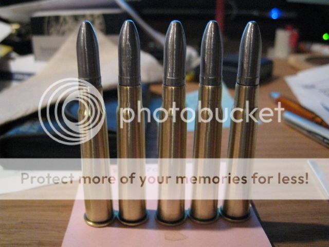

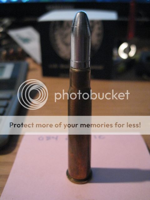

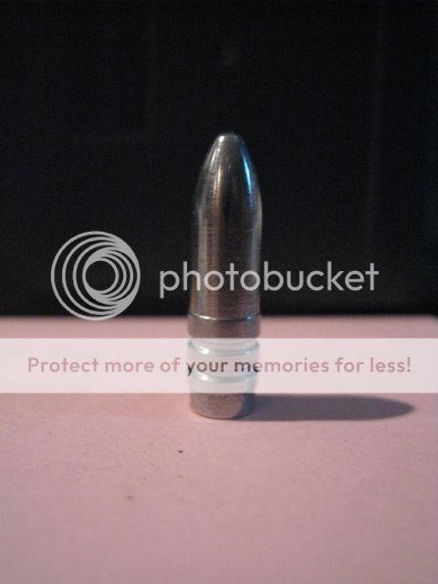

Here are pics of my Cast Boolit and loaded rounds.
Randy
The boolit is from Lyman mould 314299.

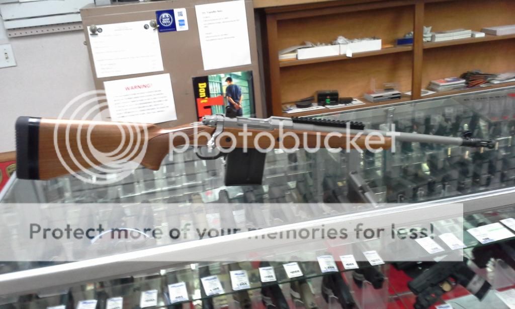

I have to tell you guys ,,, the main reason why I bought this gun in the first place was my interest in the Canadian Rangers and their function in your society. I wish we had something like this here in the US, but it would probably be deployed on our Southern Border in the desert instead of a pristine wooded northern wilderness keeping the Ruskies at bay. You guys get to do Military type things without having to be in the Military perse'. If I lived up north I would be there with you.
I might add that I was the person who tried to get Ruger involved in the refit of the Canadian Ranger Rifle. As soon as I heard about the proposed upgrade a few years ago, I called my friends at Ruger and told them about the possibility. They got right on it. The Ruger Gunsite Scout is Exactly the gun they are looking for in it's current form, with the exception of a synthetic stock which your military wants and that Ruger could easily supply.
Apparently that refit has been shelved as Your Govt wants the gun to be made in Canada. The only US outfit that has a plant in Canada is Colt.
Colt's only mag fed bolt action offering, which is actually made by Dakota Arms in S. Dakota, is $2700 US and not completely to Canada's Spec ,,, Ruger's gun is to spec and is $1100. Big difference when talking about 5000 guns. Probably a quantity break to be had there as well!

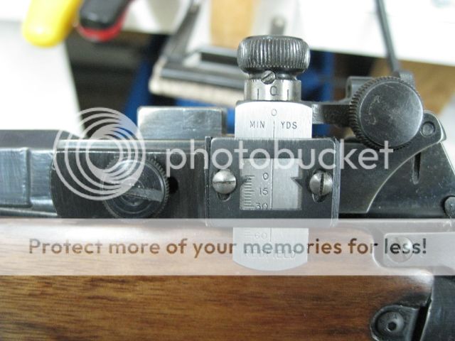

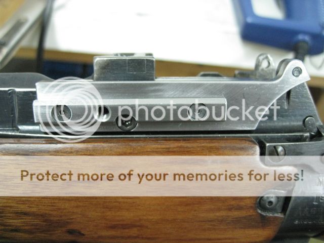

I am starting to work on a Backsight Adapter Plate to mount my Redfield Olympic Sight. I think a combination of a better Backsight and a 2-3" black square for a target will yield some better groups. The aperture in the ladder sight is simply too big for shooting targets. Be fine for hunting or shooting people which was kind of the original intent.

I don't think the Rangers are looking for a synthetic stock and hopefully DND isn't either.
Good for you for trying to interest Ruger, but the Gunsite Scout is not a patch on the No4 as has been discussed elsewhere.
RRCo: I don't remember which Action It had I was more enamored with the Bolt latch.
The Spec for the Ranger Replacement as I read it was . Bolt Action, 10 rnd. Magazine Fed,, .308 caliber, Iron Sights with provision for easy scope mounting, and synthetic stock. The synthetic stock was a big deal for them due to the cold weather.
And then finally after the fact, they decided that they wanted it made in Canada. That was the big sticking point, as nobody makes guns like this in Canada, so as a result, they haven't gotten new rifles.
Rugers proposal had everything they asked for except the synthetic stock, right out of the box, and they were willing to do that as well. In Fact there is already a Canadian Version of the rifle with a 18" bbl. Ruger is very open to doing special runs of guns for big Customers. Lipsey's gets all kinds of oddball guns made exclusively for them all the time, and I have seen several variations of the Scout Rifle including one with a Walnut Stock which showed up at a LGS recently.
I even suggested for them to set up a Warehouse in Canada and ship the guns there in pieces to be mated with their stocks to satisfy the Made in Canada ruling, but no one was interested.
I personally don't think the Govt. up there has any intention on refitting the CR as there is no immediate threat, and I think they would rather spend the $5 Million on something else.
Randy

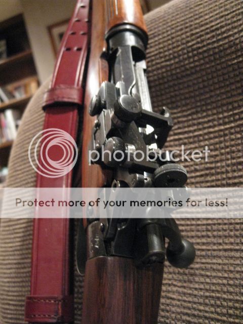

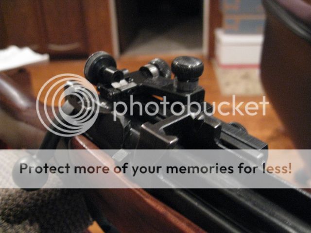

Also Done with Redfield Olympic installation to my #4. Made adapter Plate so there is no alteration to the gun. Looks like it belongs there.
Randy
Safety is easily manipulated with the thumb. Plenty of room for your thumb.
Note how the aperture is placed neatly between the Receiver Ears for the Ladder Sight.
Yes, nice work. It's a pity no one makes a base for the Central sight that does not require D&T and still allows use of the safety.
I still think you need fine threads and steel inserts for your sight adjuster though! ;)
RRCo. the sight adjuster is made from 7075 T651 Aluminum which is about 75K psi, CR steel is 60K psi. There is absolutely no need for inserts. Also the threads are 1/4-28 fine threads yielding .006 movement (3/4 MOA ) per Flat. or .036 per full revolution. You also get both Allen and Hex Head bolts.
The parts are all black anodized and there is so little force on the screws when you turn them that one of these tools should last 2 lifetimes of everyday use, you'll lose it before you ever wore one out.
Screws are stainless. and I even faced the ends so they are square and lubricated them so they run super smooth.
This is the best tool like this you're ever going to see.
I figure you should have one.
Randy

Kudos on noticing that. It is apparent when looking at a quantity of cocking pieces, as we call them: you see the thicker Long Branch ones. It's something they introduced on their own hook, but when I don't know. They probably considered a closer fit between the firing pin and the hole in the back of the bolt it passes through and decided that would wear too quickly which such a small bearing surface, compared to the upper concave surface on the cocking piece pushing against the lower side of the bolt body.
Your sight base is a nice piece of work BTW.
