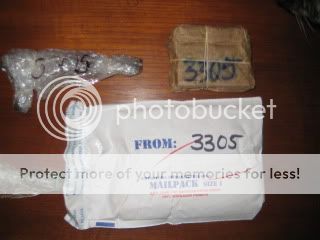

I ordered the rifle from Marstar and it arrived within 2 weeks of ordering. The packing was excellent, and there are a lot of goodies with the rifle. The rifle is currently offered with a soft case, steel scope rail designed for the rifle, sight adjustment tool, 2 matched/numbered 10Rnd mags, NcStar Scope, and not mentioned on the site,it came in a hard shell case to boot.
The fit and finish are great on every part of the rifle. It came coated in a very light preservative oil, easily wiped off with papertowel. The bolt, bolthead, magazines and receiver are all numbered to eachother. I did have to tighten a couple of screws here and there, so it's a good idea to check this before shooting, especially the main(king) screw where the target sling swivel is located.

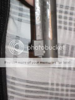

The layout of the rifle is very similar to a No.4, the sight arrangement accepts standard No4 rear sights but come with a 2 position flip sight with smaller apertures than any No4 sight I have. I would say about .020 inch diameter, so they should be very helpful in shooting. An improvement over the original sight is that it does not have to be flipped a particular way to facilitate bolt removal. There is also a trapdoor in the butt with the proper cuts for a pullthrough and oil bottle to be placed there if you so choose.
