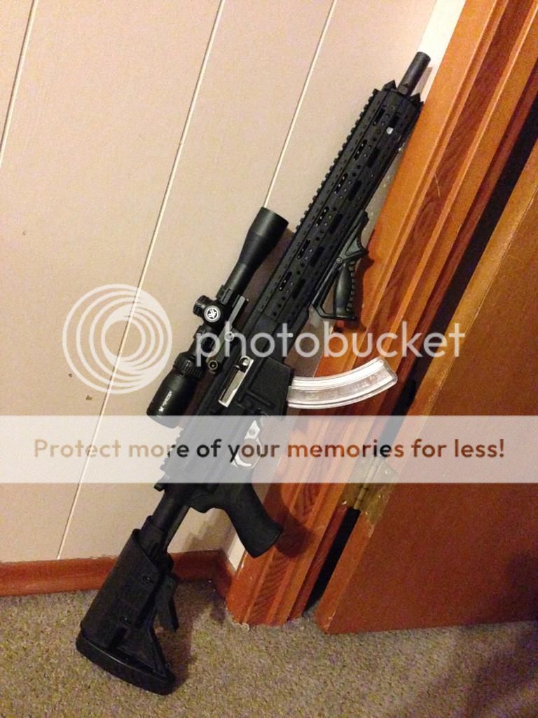

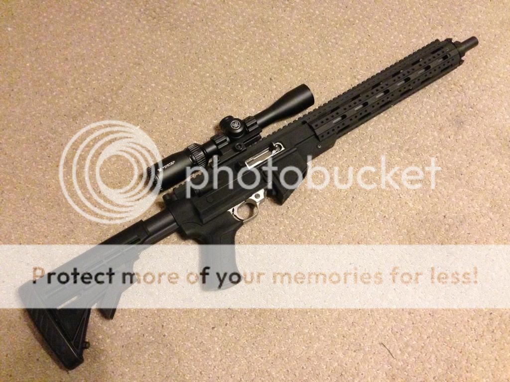

Okay, So my build is half complete.
Feels much more solid than i thought it would, Actually fit quite nice. I've felt a lot of other kits, this one feels surprisingly well built and fairly heavy, not as bad as the SR22 though.

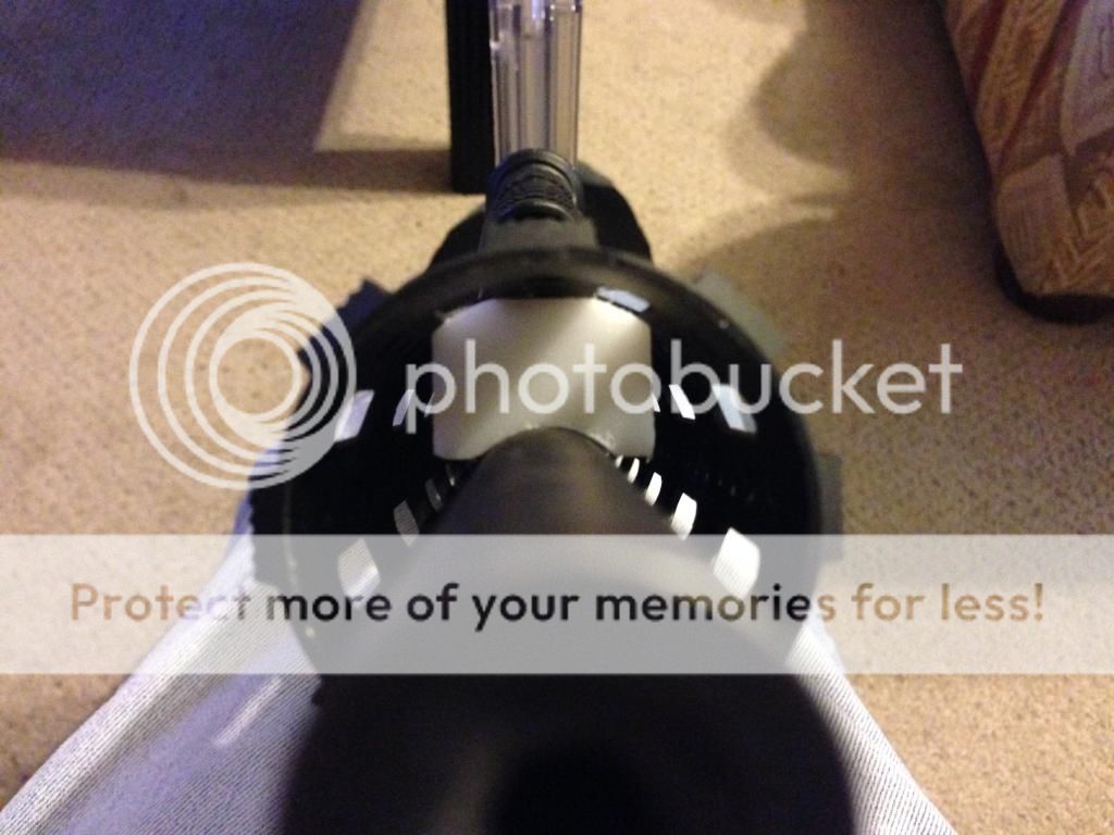

First is the mag release area, The 10/22 action i got for the donor was a 90's baby so metal trigger guard with the flat mag release. I had an extended polymer release kickin around from a previous project so i slapped it in, along with the auto bolt release mod. Well the release was too long for the cut out in the stock and I had two choices, pull the whole thing back apart to get the factory 10 rounder out or cut the release shorter, i chose the later option as i didnt wanna go back to the flat release for usability reasons, so that is shown here.

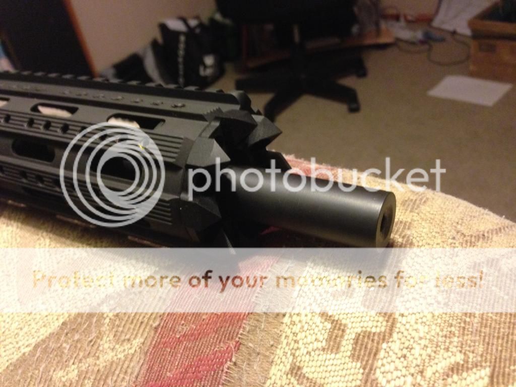

The other minus to the kit is the fore end, which ONLY will accept ATI rail sections, and by that I mean thats what they want you to use, I had an old rail section kicking around from a previous project aswell, while i was able to find two holes that line up the holes on the rail are placed in funny sections, and i have not been able to find any screws that work with the factory threaded holes yet. if i could find these screws it wouldnt be a problem using the magpul rail section other than that they dont have the grooe cut into the back side theyll just sit a little further away from the rail, of course a guy could drill out the holes and use nuts on the inside and that would work too.

I installed a SR22 barrel as I couldnt stand the look of nearly 5 or so inches of factory barrel sticking out the front end, lol
Lets get to the pics.
