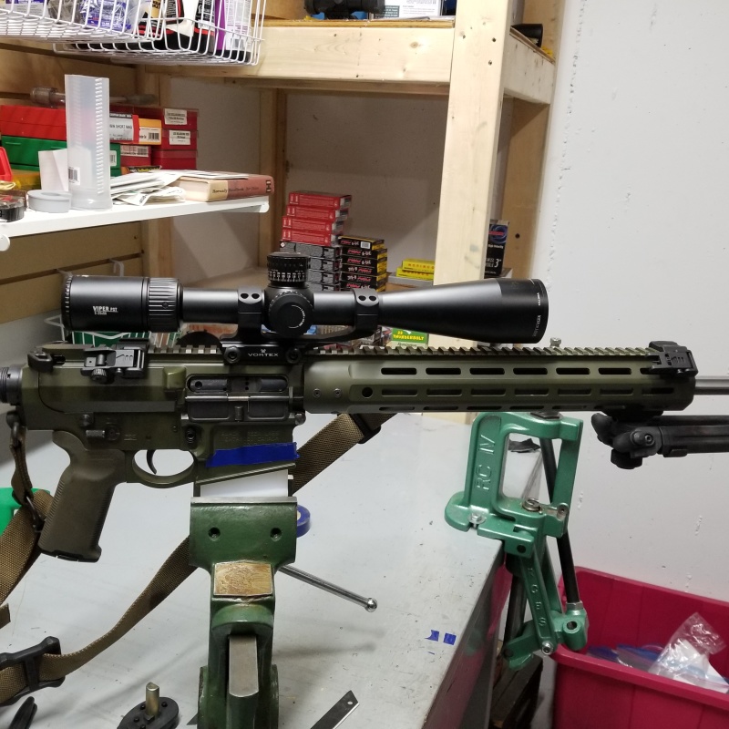

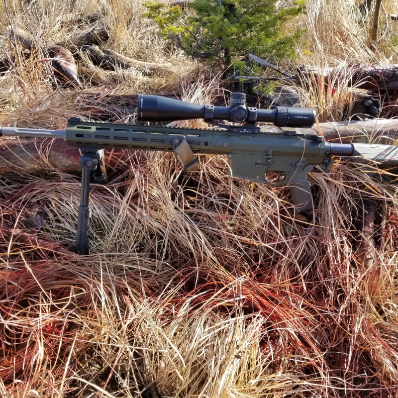

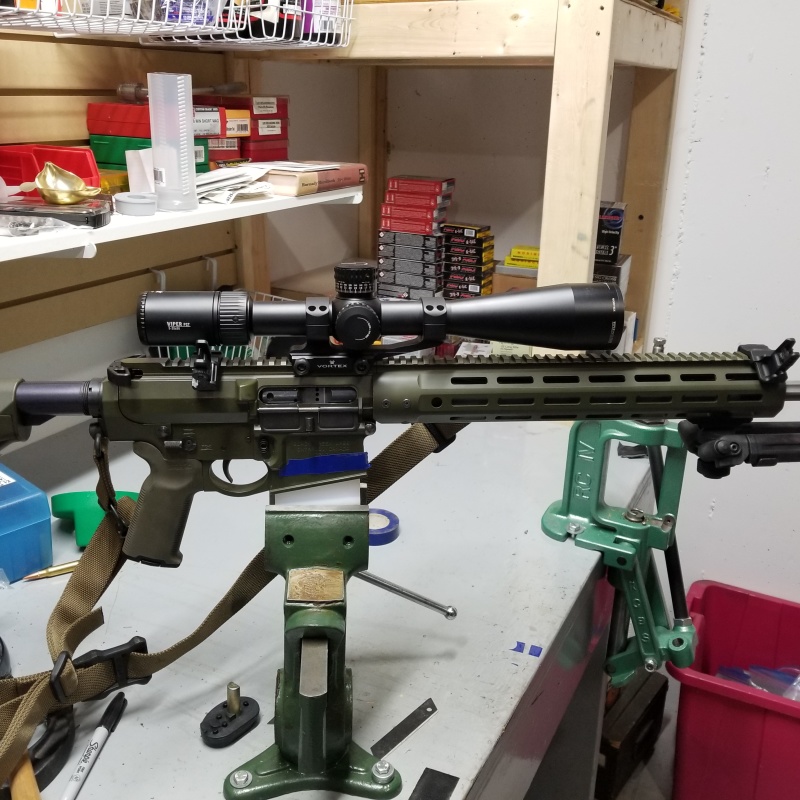

So what I have done to this rifle to date is

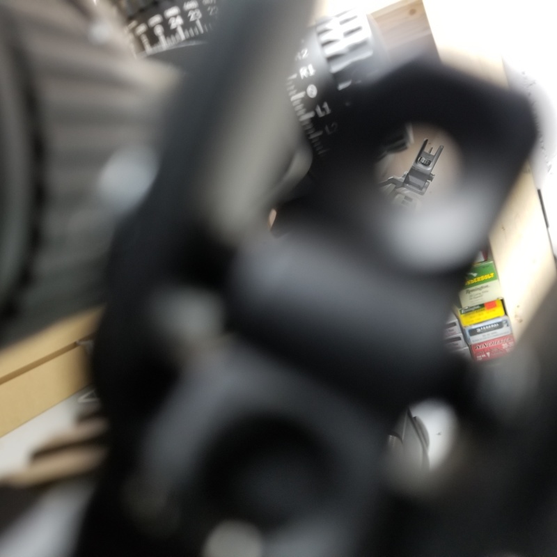

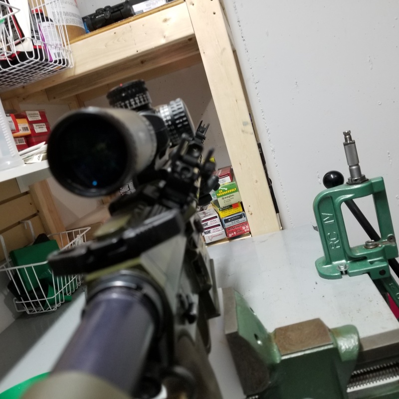

Barrle, jp silent captured buffer, raptor charging handle, ambi safety, magpul str stock, magpul moe k2+ grip, magpul mlok bipod, utg 45°buis and i have it topped with a vortex viper pst gen2 5x25x50.
As it sits the gun weighs a ton and I wish bcl would have softened the corners on the magwel but other than that I am very happy with how this rifle looks feels and runs.

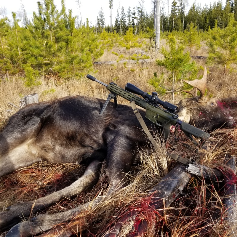

I sited the rifle on the weekend and was very happy and confident with the rifle so I went deer hunting on Tuesday and I ended up running in to a immy moose they are open for 15 days where I live and I couldnt pass up the opportunity. 160yd threw the skull and severed the spine it was a great feeling to get more than just coyotes with this gun.
