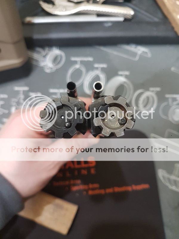

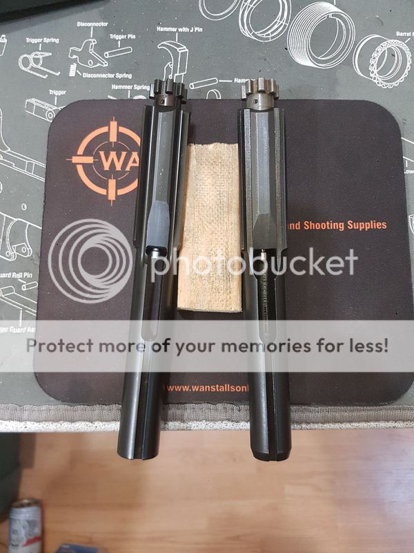

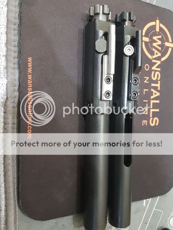

factory bcg is rather rough, plus the firing pin retainer was bent up and had to replace it with a spare one. My brownells one arrived yesterday and it was a big improvement plus the pof roller cam smoothes the action out.

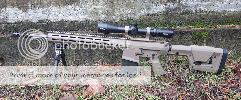

Installing the gen 3 prs stock was a minor headache. Had too use the sanding drum to ever so slightly open up were the stick meets the castle nut. The threads seem to be taller. Then i had to trim approx 1/8" of the eggs of the buffer tube with a hacksaw. Then the front edge of the portion of the tube that sets the adjustment used the sanding wheel to remove the tiny bit of material blocking the tention/qd port of the stock then it fit like a glove.

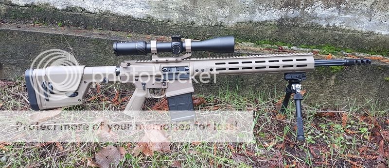

Lastly i mounted the fde aero precision ultralight mount and my cabelas 4-16 ffp covenant scope.
