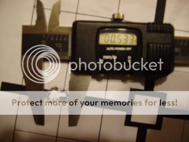

My best so far!
Well I tried 5 of each from 44.6-44.9 and well it didn't turn out so well. The point of impact was another 1.5" up and the best group was 5/8". But there was a 15km/h wind swirling around from every direction. I could blame the wind on the groups maybe the the point of impact is strange given I didn't move the scope at all.

Well I loaded up more, removed the action from the stock installed internal rail so I could mount my bipod. At this time I removed some bedding from the bottom of the recoil lug hole. So this weekend I am heading to a F class intro so I figured I better shoot off the ground using my bipod. Below are a pic the first 5 rounds down range bad part is I knew I pulled one low before I had a chance to look. Jerry was right another 2 shots really didn't a whole lot of diff.
.225" with a flyer is not bad in my books.
So in the end its going to be a 44.8 grain charge of varget with a OAL of 2.821 Avg velocity of 2822 FPS ES of 22fps. I tried changing the OAL a bit and the groups opened up to 3/4" outside to outside.
