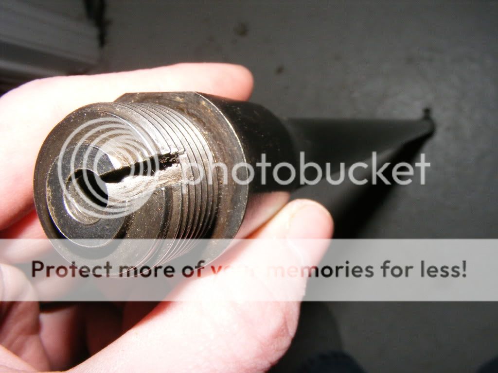

The C No7 barrel band for the front sight is not profiled for the bayo lugs as is the No4 band and is very tough to find. I used a No4 band and secured it in place with a set screw thru the bottom into the barrel. It is covered by the front sight guard and doesn't show.
Ya thats what some one did to the front sight holder on mine. It had the PH5C rear and a tunnel front sight on a #4 front sight base. I have the proper sight base to put on but unfortunately the set screw split. So a few minute job is now gonna take a whole lot longer.

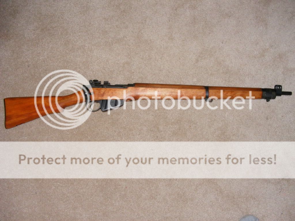

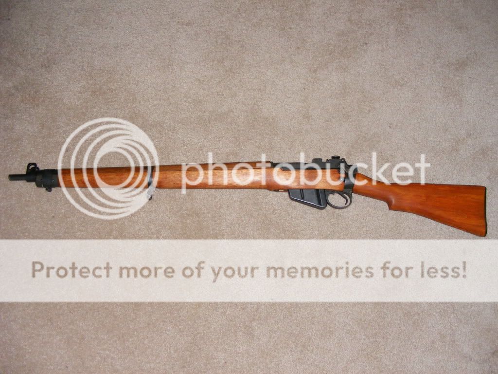

So i got the barrel today and I was shocked. It is basically brand new, bore is like new with no wear at all. Same goes for the bluing. I mocked it up on the receiver and threw the wood on. Pics show what she looks like, very happy with it. I still need to get it torqued on for the sights but ill do that in a couple weeks.
Well done!
Incidentally, if you look at the photo of the breech of the No. 7 barrel, you will notice the extension that brings the barrel face back to the boltface. If a .303 barrel is being sleeved, it is necessary to replicate this extension. I've done it by making it part of the bushing that fills the .303 chamber before drilling and lining.
