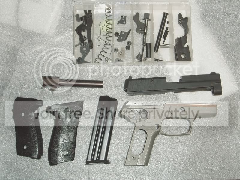

I considered posting this in one of the existing DAC threads, but I didn't want to hijack someone else's thunder.
I discovered like the rest of the folks that bought this kit, that "minor fit and finishing" was apparently a pretty broad category.
I'll try not to repeat what has already been covered in the other DAC threads, but forgive me if I do end up rambling a bit.
Assembly issues
There were numerous areas that required hand fitting modifying etc.

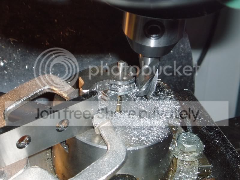

- Fitting of the hammer stop ...... this was a pain in the a$$ !!! As far as I can tell, Dlask drilled the hole for the hammer stop pin too close to the hammer pivot. My options were to weld the hole and re-drill .....( not after the last welding episode
) Or to modify the hammer and hammer stop. My new hammer and old hammer started out with the exact same profile, so you can see how much I removed.
Milling the Hammer
Hammer Comparison
