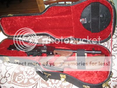

Dlask barrel
Posted pics of this build before but maybe some haven't seen yet. Full size Thompson, with working correct style drum mag.

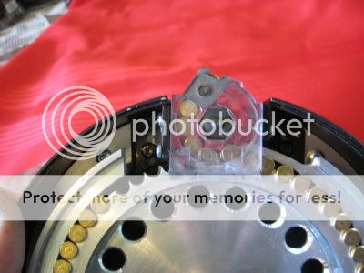

Drum mag
Metalbender, if that thing is reliable,
you better start mass producing it.
Don't think that will happen. Using manual type lathe and mill it took a long time to build. Prob as much time thinking and R+D { trial and error for those of us without engineering degrees} as in the actual finished product. A qualified cad guy and cnc equipment would make short work out of it. It also would'nt fit a regular 10/22 as it fits right up into the reciever with no stock just like the original Thompson. Very limited application I would think. I liked the look of the other Tommy guns on the sight so I did one just for my own satisfaction and it was a bit of a challenge to get it right, failure wasn't an option. I didn't like the looks of the commercial drums, like a sack of s##t hanging there.
WOW. Thats drum is real work of art! I can see what you mean. Although, if you were to "sell" the design, say to someone who does a thompson 10/22 conversion. I'd imagine you'd have to patent it, then sell the patent.....All that aside, i can appreciate what went into it! Good work!
