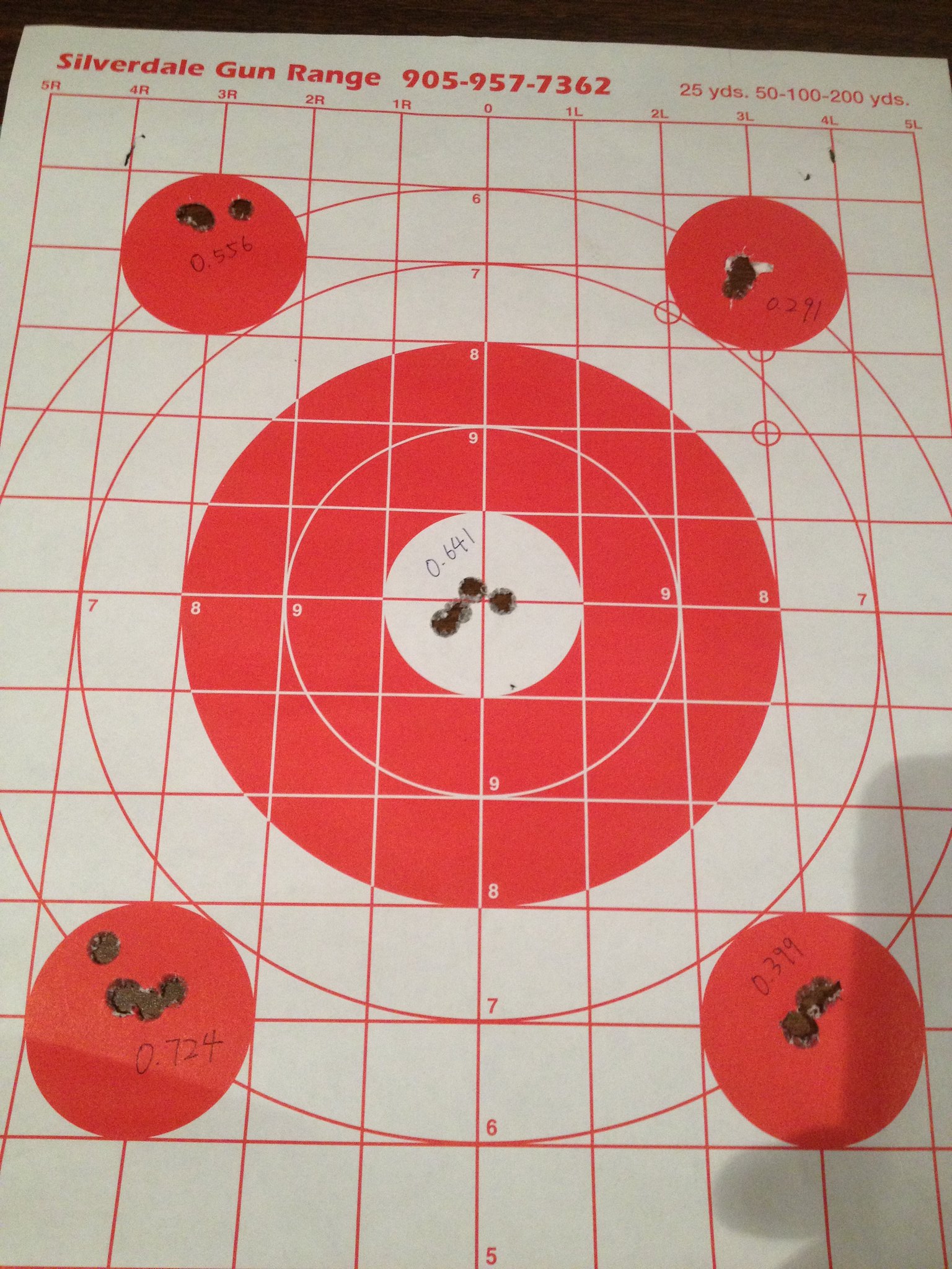

So Heres my attempt, 5 group, 5 shots of each group, at 100 yards.
Top left: 0.556"
Top right: 0.291"
Center: 0.641"
Bottom Left: 0.724" (woow that was close!)
Bottom Right: 0.399"

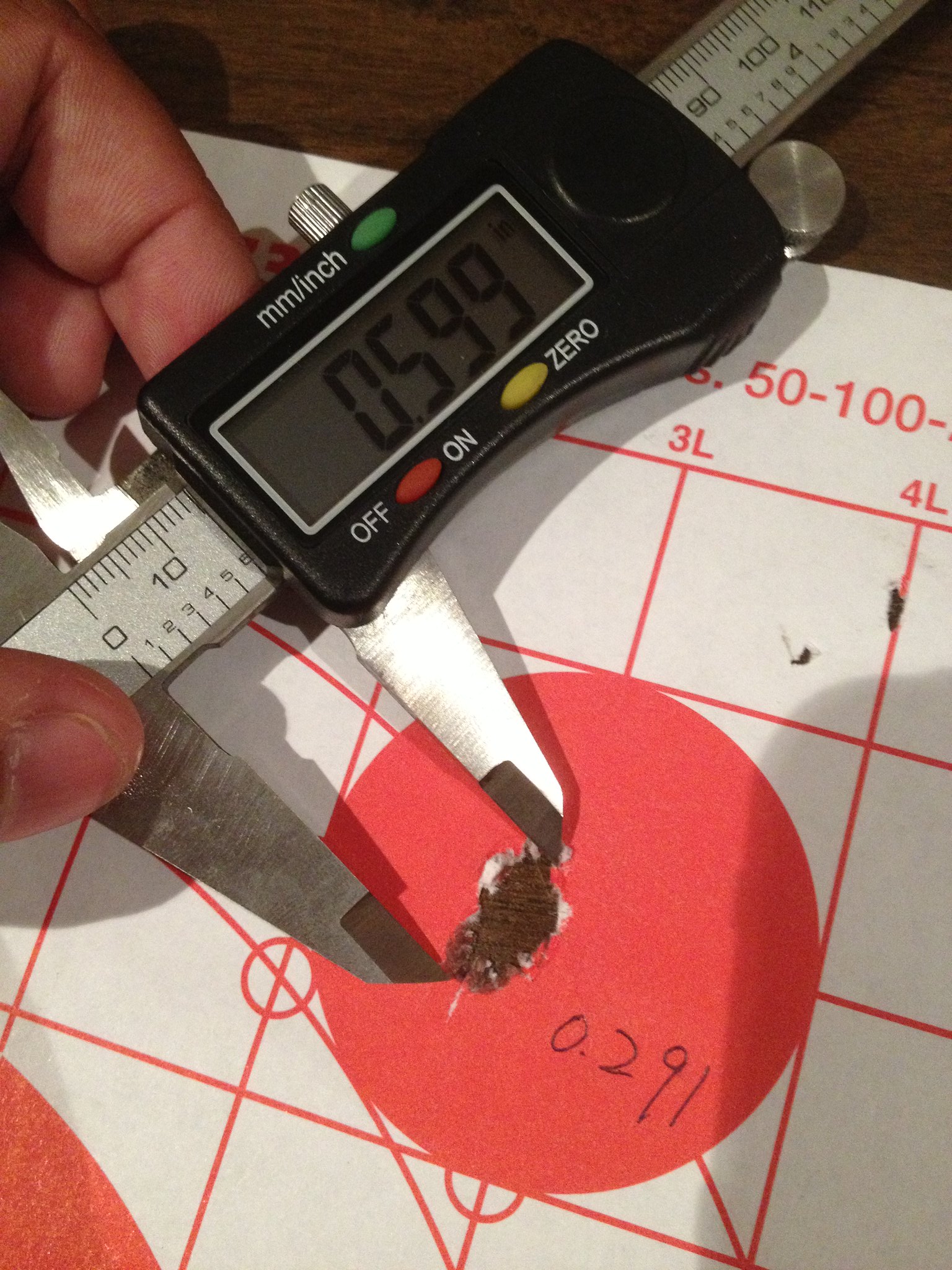

Smallest group: 0.599-0.308=0.291"
Average: 0.522"

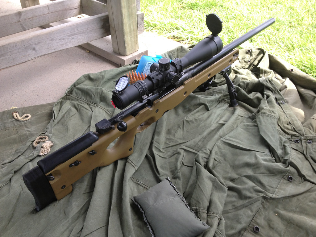

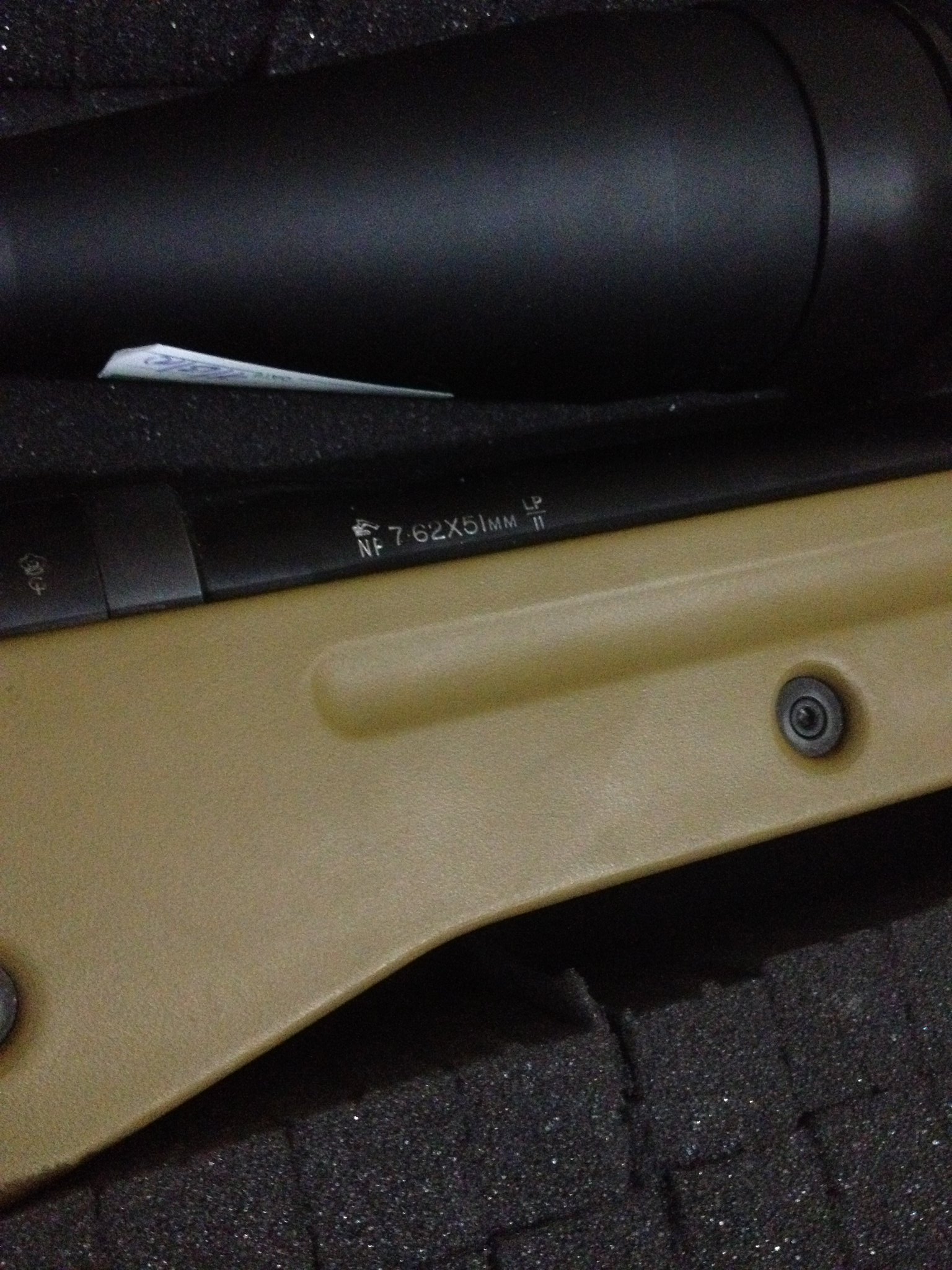

my hardware:
ACCURACY INTERNATIONAL AE 308
20" Factory barrel
Factory stock
Factory action
Factory trigger
Factory bolt
Well everything is factory out of the box, so I think my rifle is qualified in this challenge right?
Im shooting handloads, Im gonna improve my shooting and do the 0.5MOA challenge next time!
