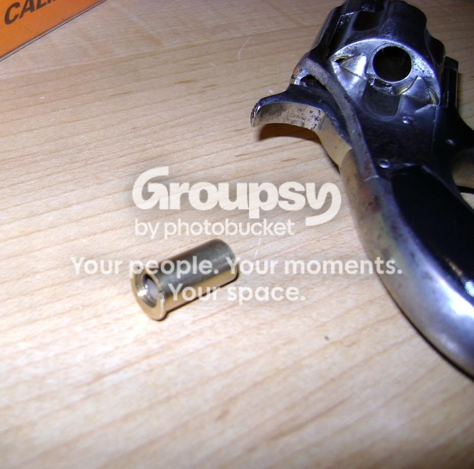

Allrighty fellows, I just received my first antique in the mail today. It's a Remington No.4 New Model revolver that I acquired in a very nice shape and, may I add, at a very good price from Mr. Dingus.. who was very helpful, honest & prompt every step of the way (thanks again for all you help bud!).
Anyway, the gun looks & works very nice, has clean chambers, seemingly good timing and a good bore, with some minor pitting and visible rifling. I bought this gun to see how I like this whole antique thing and I am pleased to say that I have fully converted. The absence of the useless registry getting involved here is always the biggest plus... it basically gives you the feel of the way it should always be for law abiding citizens - in a perfect world, that is. :rolleyes:
Anywho, because the gun is built to use very hard to get ammo (.38RF), I will only be using the "Dixie Co." brass - basically, it's an empty case adaptor for .38RF and the way it works is that you stick a 'starter gun' .22 blank bullet on the rim side, fill the case with black powder and stick a .38 lead ball on the other end, pushing it in approx. half way... and that's about all there's to it.
Now, if any of you have experience with the Dixie stuff, could you tell me what BP is best to use in order to keep the pressures at their lowest and to get the cleanest results? Since the gun is an antique pocket revolver (even though it is in a nice condition), I am not sure if I want to experiment with too strong of a powder. I am still a newbie to reloading and especially BP. Also, if there's a simple & safe way to use smokeless in Dixies, I'm all ears... as I've recently acquired a 1LB of HP-38 to reload my .38 special... so I guess you know where this is going, lol! :nest:
Anyway, here's some pics of my newest acquisition: :D
The Remy and his 5 best & rarest friends in the whole wide world: :D
Ok, these aren't the .38RF bullets in there... they're only the empty Dixie shells! :p
Dixie shell close-up:
P.S. Also, can anyone tell me where to get .38 lead balls (.370 diameter)? I went around town last week and no stores around here have any. I'd need approx 1 box of 100 to start. Thanks in advance!

Allright, thanks... but I only need a few balls (lol.. that doesn't sound right!), plus I forgot that it's a .370 I need, not a .310... I got mixed up with the requirement for.32RF Dixie cases - mine is a .38RF, so .370 balls are needed. Sorry for the confusion, I'm still a bit of a lost FNG here... :D
I would use 3F black in the gun and just fill the case to the level of the base of the ball.
cheers mooncoon
Thanks mooncoon, that,s the info I was looking for. I have bought some 3F BP substitute (the maker is "American... (something)") and it says that it burns clean + gives good velocities with the same charge. Originally it was purchased for my Lyman Deerstalker flintlock rifle, but I haven't used/fired it yet either.

I have a mold for .375 heeled bullets would they chamber? its a mold I had from a 380 cal hills patent self extracter I used to own
I would start by slugging the bore; I think it should be .380 or close to. .390 round ball is semi common; they are used in 40 cal rifles. You could size them to .380 or a little under and glue them in place with airplane glue. Try loading two and firing one then check to make sure that the second one does not come loose with the recoil.
You could make an el cheapo sizing die by drilling a 3/8 hole in a piece of 3/8 to 1/2" steel and opening it up slightly. You also could probably create a heal on the ball by drilling a shallow hole .360" diameter at a guess, in a piece of larger rod and stamping the heal onto the ball. With a bit of luck there is a letter drill the right size.
Finally with black powder substitutes you want to be sure that it generates the same pressure for the same volume as black.
cheers mooncoon
Thanks.. I have a double cavity .38/.357 semi-wadcutter Lee mold coming to me in the mail (for my other reload needs), so I'll see if that fits. I have exactly 2000 .38 special semi-wadcutters already (all lead, made by Remington)... butI really wanted to try the .38 balls first.
cheers mooncoon
Thanks for the info, I'll look into that. As far as the powder substitue is concerned, I have no idea about pressures... I'll have to research it before loading.
