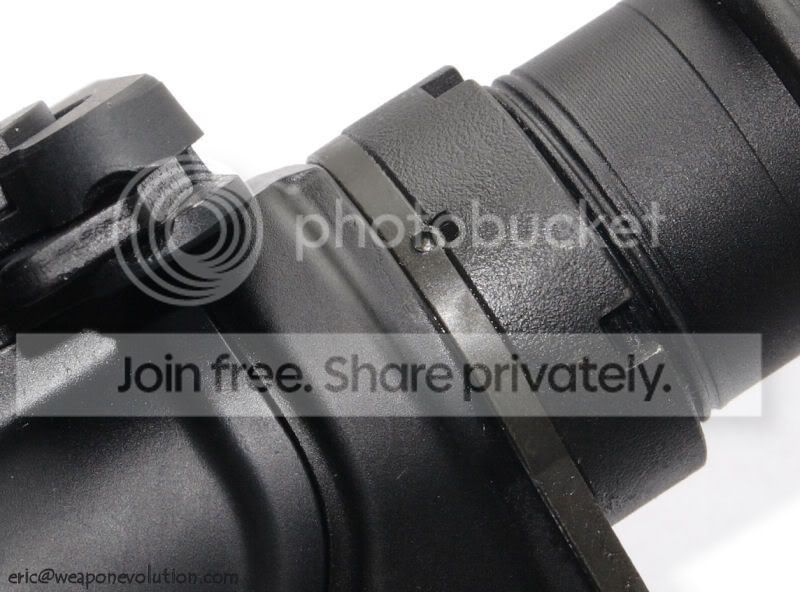

Apart from the poor attempt at staking the castle nut, the rest of the things you listed are normal for a new AR15 that has been test fired for function at the factory.
Ignore the people that say it doesn't need to be staked, they don't know what they are talking about. Castle nuts can and do come loose, and can lead to malfunctions and parts breakage. Also, never loctite a castle nut, it is harder to get off than staking. Staking can be easily broken using a proper castle nut wrench when you want to change out anything.
If the staking on one of the other two points is the same, or not staked at all, then stake it before shooting it, although you should probably stake it properly anyway. It should look like this:
It is easy to do with either an automatic center punch, or a punch and hammer. A couple of hits should do it. It can then be touched up with some matching black paint if you like.

Wrong. I'm not even going to bother debating this with you. If it isn't staked, then it isn't "properly installed".
Some receiver extensions do not require staking, such as rifle receiver extensions, and the couple you mentioned, but we are talking about standard carbine lower receiver extensions here.
Every reputable manufacturer stakes the castle nut/end plate; Colt, BCM, Colt Canada, DD, LMT, etc..
Those that don't, generally make "just as good as" guns, and tend to cut corners with a lot of other parts as well.
A "properly installed" castle nut should be torqued to 40ft/lb +or- 2ft/lb and staked in at least one or preferably two spots.

I bought two of the M&Ps, here is the stake job on mine. Not as pronounced as the OP's but not as "pretty" as some stake jobs either. They don't bother me.
