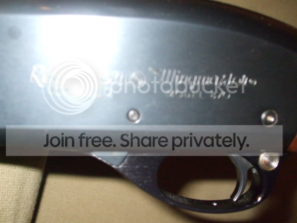

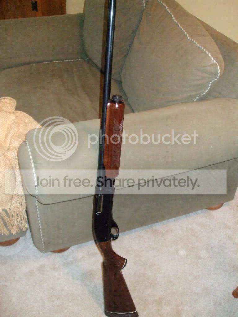

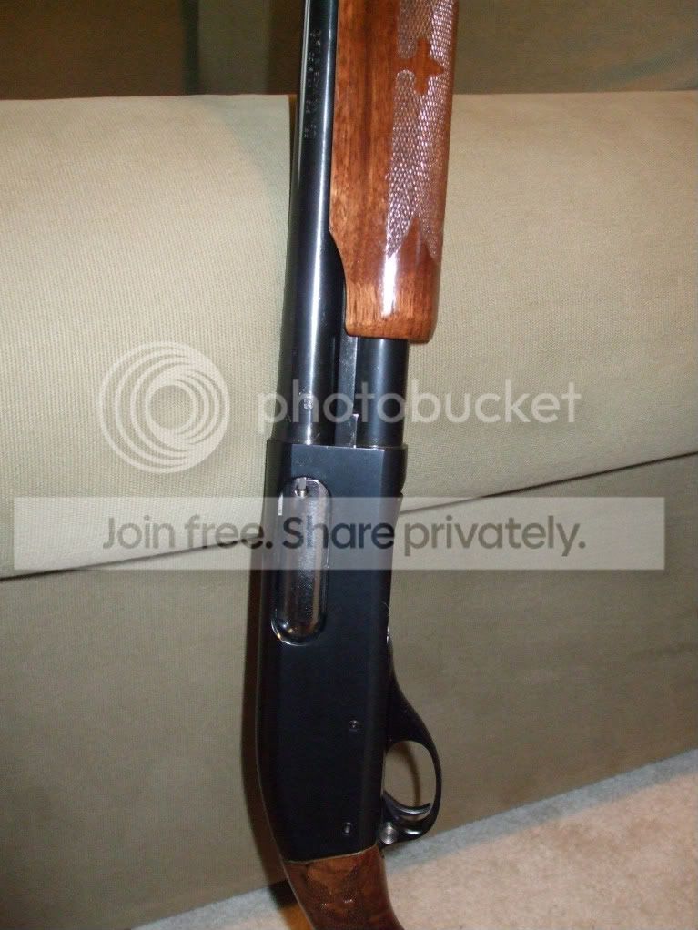

I just got my first non black/tactical shotgun in the mail today...a Remington 870 Wingmaster I bought for a steal on the EE. The shotgun is MINT...its an older style Wingmaster...28" barrel, FULL choke, 2 3/4" shells ONLY. LOVE this thing!!! :):):)
A few questions...
- Can I shoot steel shot outta it?
- I assume all LEAD buckshot is okay?
- Slugs...bad idea?...espically with a FULL choke?
Here are a few pics...my camera kinda sucks but it works
