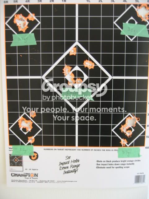

4. This was also my first-time use of Hodgdon Clays. Pros: cheap. Cons: inconsistent metering with LnL powder measure (I thought it was pretty good, actually, until I tried Clays). Lots of smoke, dirty. Mind you, I load light. The recommended OAL is 1.200", but I load to 1.265", only because my STI Trojan lets me.
I'm using Canadian BDX 180gr FMJ.
I made 5 batches of eight, from 3.4gr to 3.8gr. Overall, I like the lack of recoil compared to factory loads. I'm still a newbie when it comes to judging load accuracy, but I think I'll stick with 3.5gr - at least until I get the chrono I ordered.
Top right: 3.4gr
Top left: 3.5 gr
Bottom left: 3.6gr
Bottom right: 3.7gr
Center: 3.8gr
