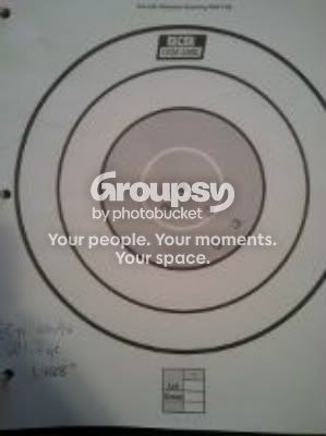

I'm pretty pumped about my results with my second batch! The pics suck but here's what they are in order. I was using my Savage 10fp .223 with 60gr vmax, varget powder, and remington 71/2 sr primers at 100yds with 5 shots on each target. I don't have a chrony so I'm not sure of the velocities. I looked at every case after being fired and none of them show any signs of pressure. Any input from you guys would be great.
1-24gr

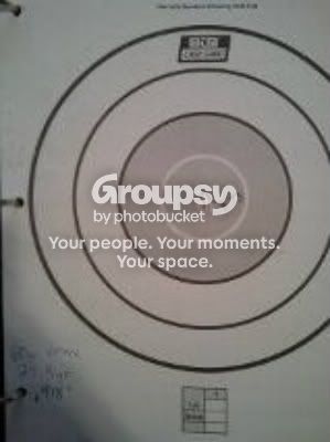

2-24.2gr ( don't know what the f**k happend here)

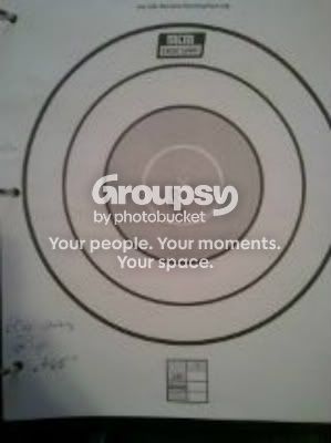

3-24.5gr

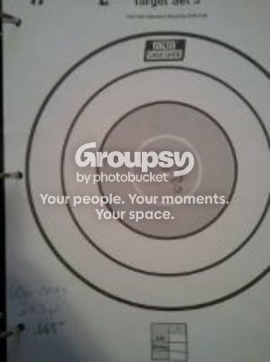

4-24.8gr

24- good group, but to much virtical stringing, this will REALLY show up at longger range
24.2 1) your rifle really doesnt like this load or 2) you really #### the bed lol, id reshoot it just to see
24.5 - getting back into a nice group but you can still see a fair amount of virtical stringing, same as 24, will really show up at distance.
24.8 minus the "flyer" there is almost no virtical stringing, which is what you want, til is by far the best load, but i would personaly try coming down to 24.7 to see if you couldnt get that group to tighten up just a bit more
