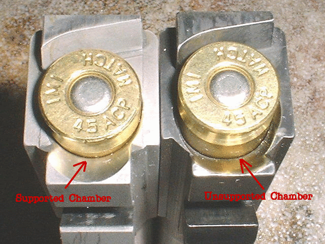

Also googled a couple pics that show the difference.

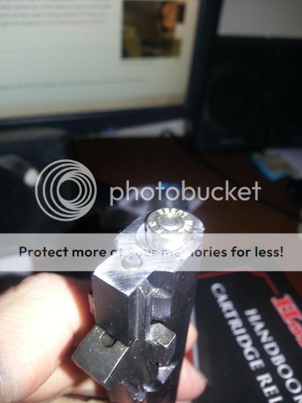

This is a pic of a sized case in the chamber the barrel is in the slide and the extractor is seated in the groove of the case. The recoil spring is removed and the lock block pin has been pushed in to simulate lockup and to give a clearer view.
So unless your slide does not have the cutout for the case head I don't believe you.

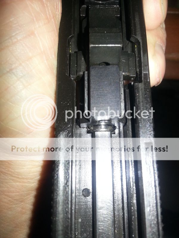

Then have a look. Live round in chamber, feed ramp almost flush with edge of extractor grove, almost none of the case above the groove showing.
