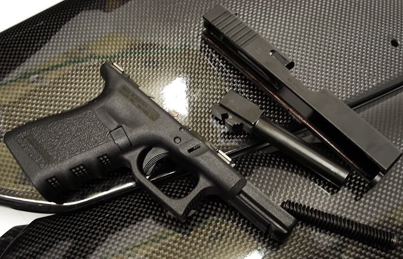

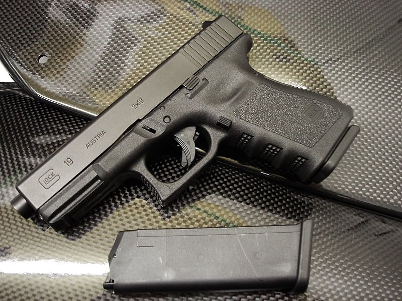

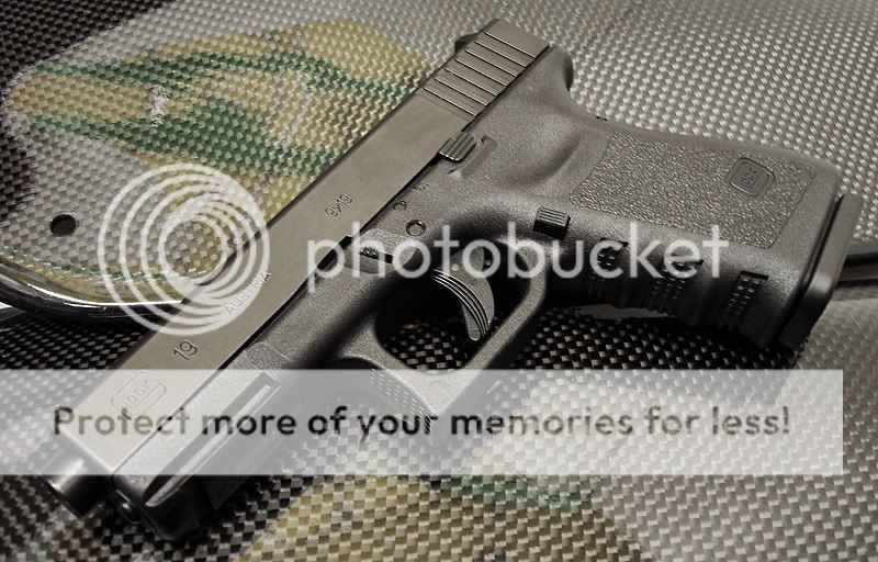

To start off with I guess a few pictures of the Glock 19 that will be going under the knife.
As you can see from the pictures this pistol is fresh out of the box. So the first thing I will do is get her all cleaned up.

Just finished a detail strip of the Glock 19. Cleaned her all up nicely.

The background that I used for the photos is a Yamaha R1 08' mid fairing. I work with carbon fiber making bike parts every day so I figured that it would look nice. Its always easier to shoot dark on dark.

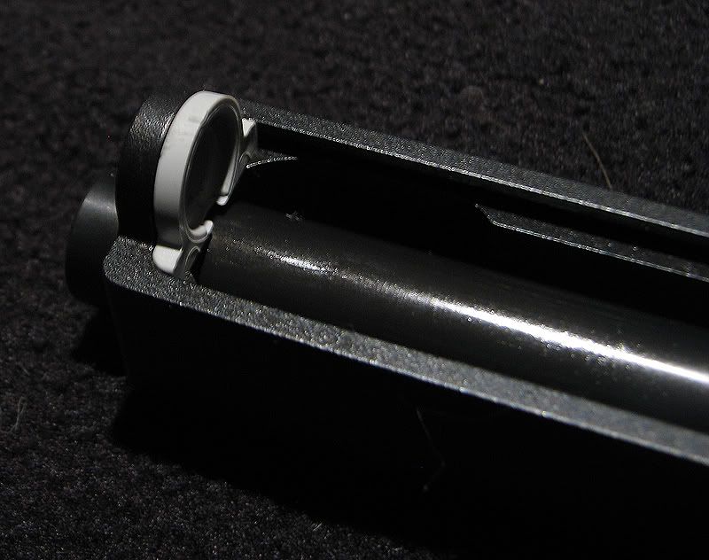

Recoil Buffer$9.99 @ www.glockstore.com
Our Recoil Buffer for the Glock pistol eliminates the metal slide from impacting the polymer frame. This repeated impact batters the frame where the two parts come into contact. Stopping this battering is accomplished by inserting the buffer between the recoil spring and the slide. Each time the action is worked or the weapon is fired the buffer comes into contact with the frame, not the metal slide.
Installation of the Recoil Buffer will result in reduced felt recoil, enhanced muzzle control and a longer service life.
Fits Glock Models:
17, 17L, 18, 19, 20, 21, 22, 23, 24, 24C, 31, 32, 34, 35, 37, 38 and 39
Does not Fit Dual Spring Glocks

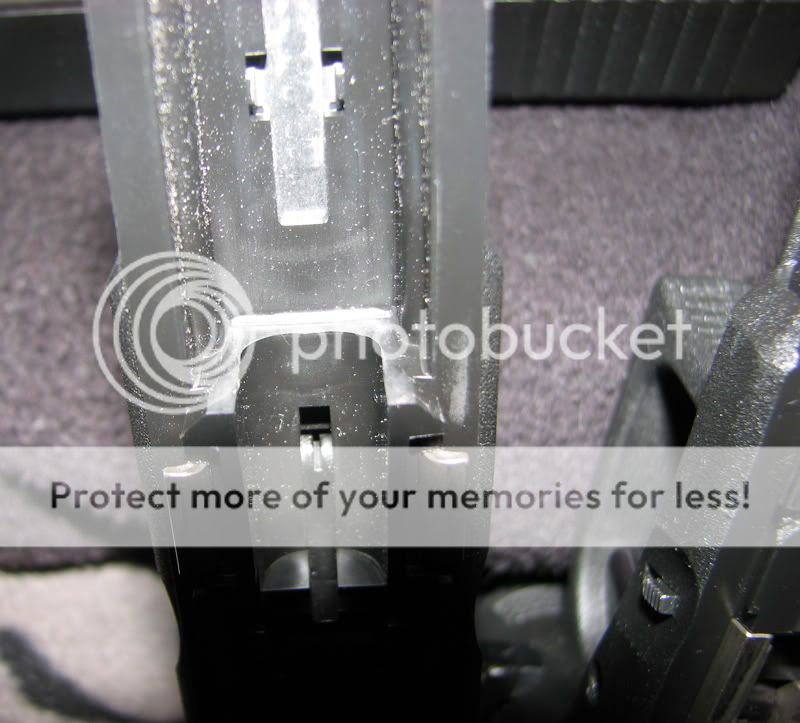

IMO this is a MUST HAVE mod for any Glock I have. So far I have owned 5 Glock's and every one of them has had this little piece in them. I have never noticed any reduction in the felt recoil when I shoot with this item installed or not but what I do notice is my frame does not get beat up.

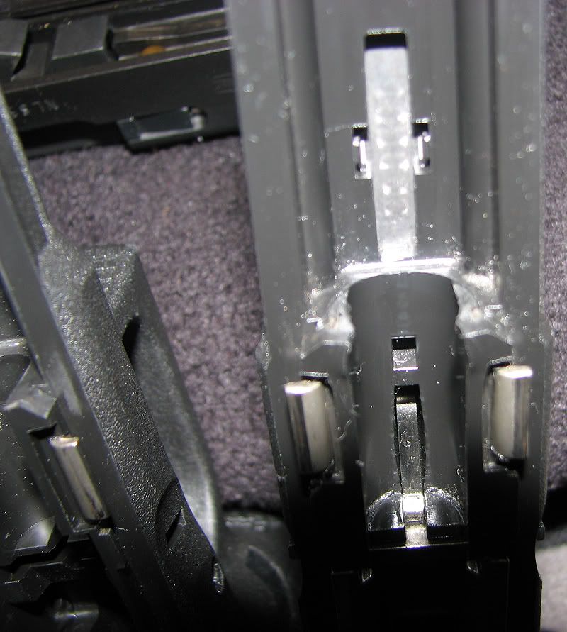

Below I have two pictures. The first one is the Glock 19 frame. It is looking at the polymer are just ahead of the forward most frame rails. Notice how the are nice and smooth with no metal showing.
The second image is of my Glock 22C. This gun had around 35000 rounds through it before I installed the recoil buffer. Notice anything different? Thats right, you can see the forward edge of the frame rail poking through. The slide has impacted the frame so many times that it has beat down the polymer. Keep in mind I was using the stock recoil spring so this is not a case of a weak spring causing the damage.
Glock 19 forward frame rail area
Glock 22C forward frame rail area. Notice how the edges are mushroomed in and the rail is exposed through the polymer. Sorry for the bad pic :p
So if you are an avid shooter and spend a lot of time behind your Glock I highly recommend this modification. I have yet to have one problem with any of my Glock with this installed. 100% reliable still.

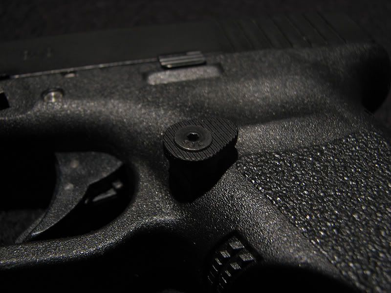

Extended Slide Release $17.99 www.glockstore.com
A little longer than standard unit for better leverage, this factory GLOCK extended slide stop lever has a built-up portion that allows the shooter to get a better grip when releasing at increased speeds. There is no need to change hand, eye or head position – due to the feel of the lever. The Glock Extended Slide Stop Lever also reduces recovery time for both strong and weak hands.
There are two different models for the Extended Slide Stop Lever.One is for glock models manufactured before 2002 and one is for glock models manufactured after 2002.
Look at the photo of this item to compare what is currently in your pistol. Pay special attention to the "spike limiter" located just above the trigger pin hole. Slide Stop Levers with the "spike limiter" will only fit in the two pin guns....which were manufactured before 2002.
This is another modification that I do to all of my Glock's. From day 1 of owning my Glock I hated the flat slide release. I found ti very hard to operate quickly and efficiently without changing my grip on the gun. There are a lot of people that have no problem with there stock part but I find that the extended controls make the gun just that much more pleasurable to shoot.
This one is not something I recommend to people often unless they complain about it. If you find that you have trouble using the stock release than this is something to look at.
There are a few different options out there but the one I like is the OE Glock release.
This is the Sure Touch model. As you can see it extends much further back that the Glock item. This would ideal for someone with small hands who has trouble reaching the Glock item. This piece is more expensive tho, around $36.

JP Enterprises Extended Magazine Release $24.95 www.glockwarehouse.com
JP Extended Magazine Release. Oversized button enables you to change magazines without shifting your grip.
This magazine release is an item that I have never used before. I have used the OE Glock extended one as well as another polymer one offered by www.glockstore.com.
I found the OE Glock one looked and felt just as bad as the original one in the gun. It just stuck out farther and I wanted something that moved the contact pad further back. This release definitely moves the contact area further back. The actual button head is made of aluminum and anodized black. The body of the release is actually just the OE Glock item that they tapped for the screw to fit in.
This release is not something I would recommend and if I could do it again I would not use this one.
I have used this one on my Glock 22C and I love it. The button does not sit to tall and moves the contact surface further back.
The next one I will use for the Glock 19 will be from LoneWolf
It seems to stick out just as far as the OE part does (which I like) but moves the contact patch more towards the rear making mag dumps easier.
The only downside to this one is you have to send the frame to LoneWolf to have it opened to accept the release (no going back to stock part after that).
With extended magazine release buttons you may find they do not fit in some holsters so make sure the one you use will fit the gun with the button in place without releasing the magazine!

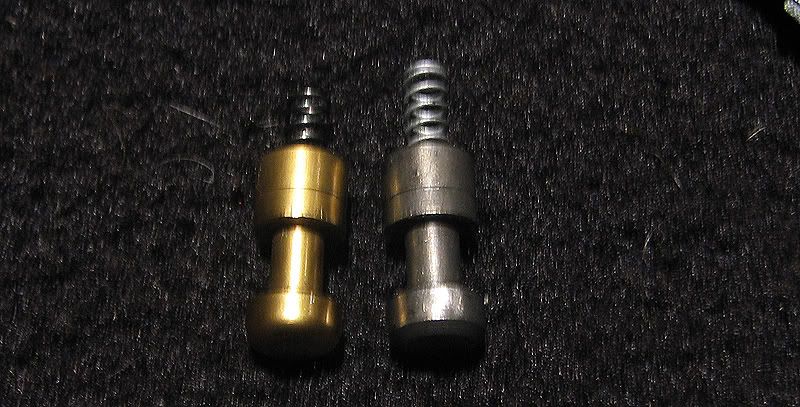

Lightning Strike Titanium Safety Plunger $21.99 www.glockstore.com
This replacement Safety Plunger helps provide a smoother trigger pull and, hence, better accuracy! The surface area has been slightly rounded and the part is machined from a solid billet of heat-treated titanium. That reduces the friction of the trigger bar on the safety plunger and reduces the effort needed to pull the trigger. Again, that’s what gives you better accuracy.
At the price point for this item I think this is another must have mod. The 25 cent trigger job address' the fact that the stock plunger has some rough surface area and can be polished for a better trigger feel. Doing the polishing to the stock piece makes for a smoother trigger and marginally lighter trigger pull.
Replacing it with this titanium one lightens the trigger pull further and makes it much smoother. The plunger does come with the spring as well.
